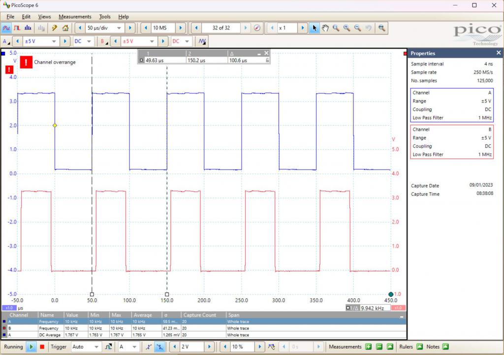

This initiates the PWM on channels where a deferred start was defined or just syncs exisitng running channels. However, the power comes in the ability to offset the channels one to another (defined as a percentage of the time period as per the duty cycle - can be a float)
In this thread  a method is described to create two signals with one starting after the other and ending before it.
With the new functionality this is easy without pokes or changing frequency.
setpin GP0,PWM
setpin GP2,PWM
PWM 0,10000,50,,1
PWM 1,10000,40,,1
PWM SYNC 0,5

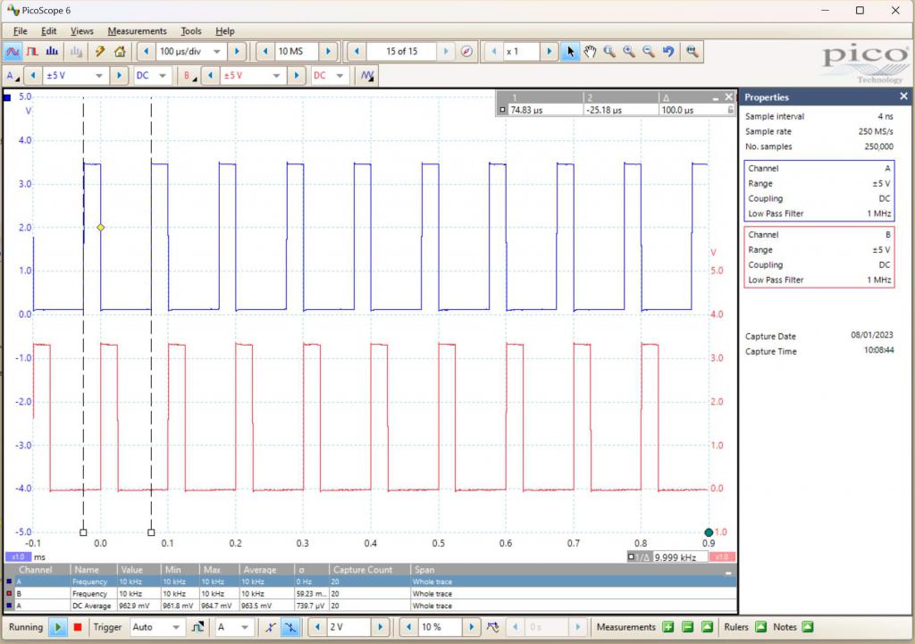

The same method can create a quadrature clock
setpin GP0,PWM
setpin GP2,PWM
setpin GP4,PWM
setpin GP6,PWM
PWM 0,10000,25,,1
PWM 1,10000,25,,1
PWM 2,10000,25,,1
PWM 3,10000,25,,1
PWM SYNC 0,25,50,75
Unfortunately I don't have a 4 channel scope
