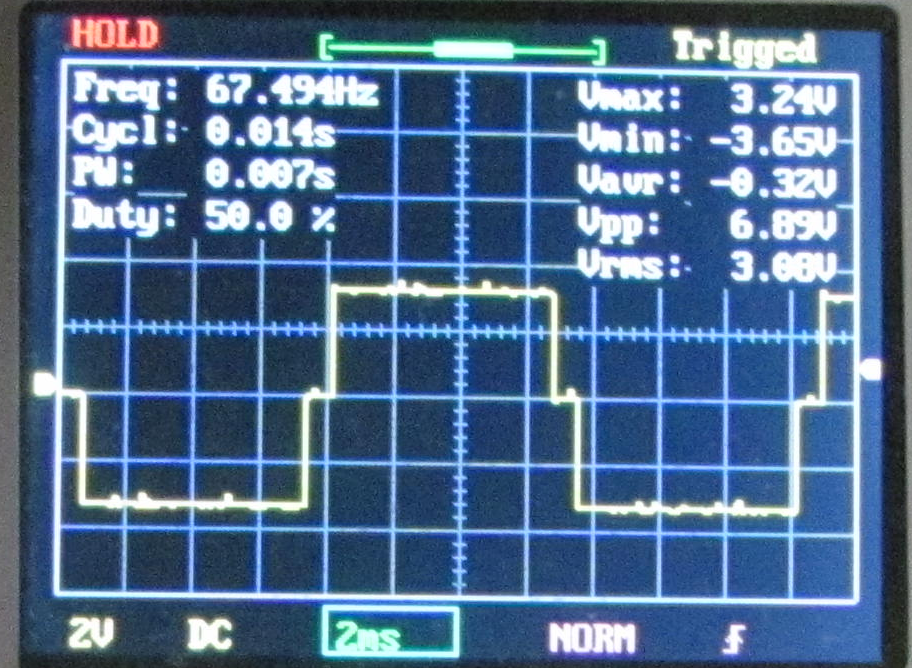

Posts: 3417
Posted: 09:01pm 07 Jan 2023
Did this 40 years ago. Simple square wave inverter, 2 transistors driving the secondary of a very small 240V to 12-0-12V transformer.
The capacitor value isn't critical. It still worked at 78 RPM.
The new Pico PWM -Duty option would be ideal for producing the inverted and un-inverted waves for the push-pull drive , if only I could get it to work. There doesn't appear to be any inversion.
"Duty cycles are specified as a percentage and you can use a negative value to invert the output (-100.0 <= duty <=100.0)."
I expected this to do it.
Setpin 1, PWM
Setpin 2, PWM
PWM 0, 67, 50, -50
Posts: 6198
Posted: 09:15pm 07 Jan 2023
I posted a single register change (poke) to make pwm symetrical. So you can have 45% duty cycle at one, and 45% at the other pin, and 5% gaps at bpth leading and trailing edges.
Works better when driving a transformer
Posts: 3417
Posted: 09:24pm 07 Jan 2023
Re the new PWM.
It's the PicoVGA that I used above, Just tested the LCD one and it does work.
@Volhout
Yes, for bigger transformers that is necessary but for the tiny one needed for a turntable motor it didn't matter.
Edit
Very nice!
> setpin 1,pwm
> setpin 2,pwm
> Poke word &h40050000,3
> f = 45 / (100/3) * 50 * 2
> ? f
135
> pwm 0, f, 45, -55
Differential between pins 1 & 2
