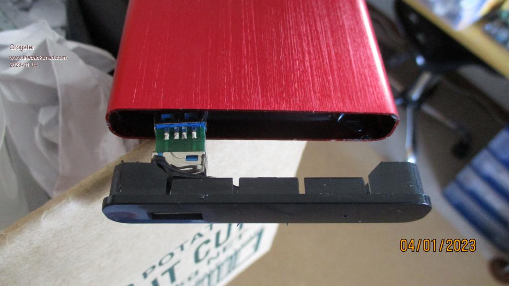

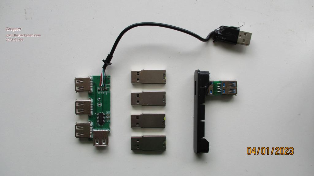

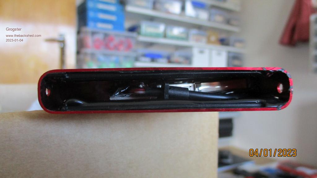

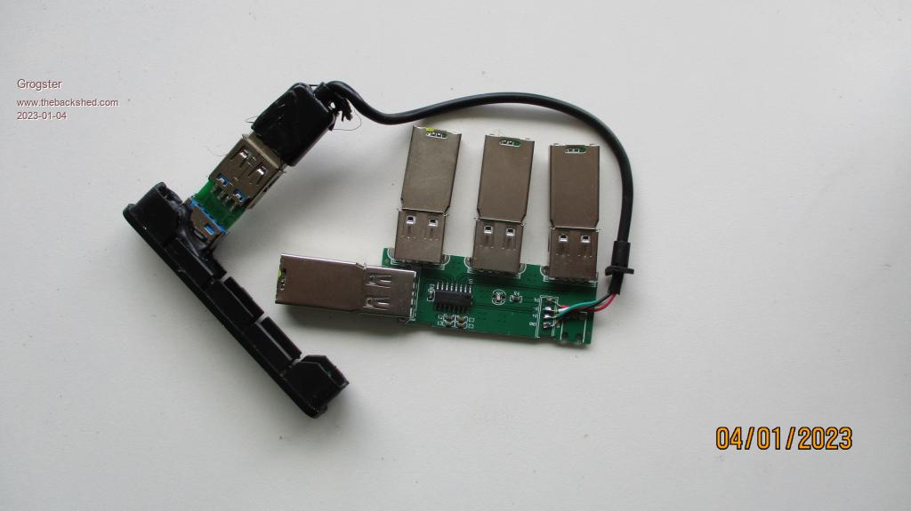

Cracking it open revealed:
So, using a USB3 socket, but very much a USB2 speed arrangement inside, so is slow AND will not have anywhere near the capacity, and gawd only knows what happens to your data if written to this thing.
This scam is probably actually quite lucrative, considering they are probably building it for about $10 including case, and selling it for $50 + postage per unit.

No, never even bothered to plug one of the four in.
It will be reporting as 2TB - which again, is not possible in current USB flash-drive flavours.  You CAN get 1TB flash drives for NZ$305 each.... link
As your edit says, they WILL be some kind of cheap flash-drive with a fake ID to trick the computer into thinking it has much more then it really has.
Would not surprise me if they were 2GB drives ID-ing as 2TB.
In any event, not something to use for anything anyway, as they are also totally unbranded.  I did crack one open to have a look inside, but the build-quality was so horrible, I just swept the entire collection of bits into the bin once I had take the photos and posted the thread.

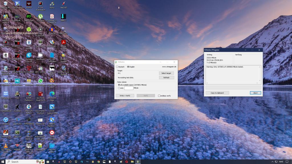

My win 10 pc's have only usb2. Should it take 70 hour? :)
My rpi400 has usb3 but will the linux version work on it?
Posted: 06:34pm 05 Jan 2023
Warning: Only 33772 of 1999983 MByte tested.
The media is likely to be defective.
20.2 GByte OK (42493056 sectors)
12.7 GByte DATA LOST (26672000 sectors)
Details:2.3 MByte overwritten (4866 sectors)
0 KByte slightly changed (< 8 bit/sector, 0 sectors)
12.7 GByte corrupted (26667134 sectors)
65 KByte aliased memory (130 sectors)
First error at offset: 0x0000000510b90000
Expected: 0x0000000510b90000
Found: 0xffffffffffffffff
H2testw version 1.3
Reading speed: 17.7 MByte/s
H2testw v1.4
If it's too good to be true.... etc.  :)

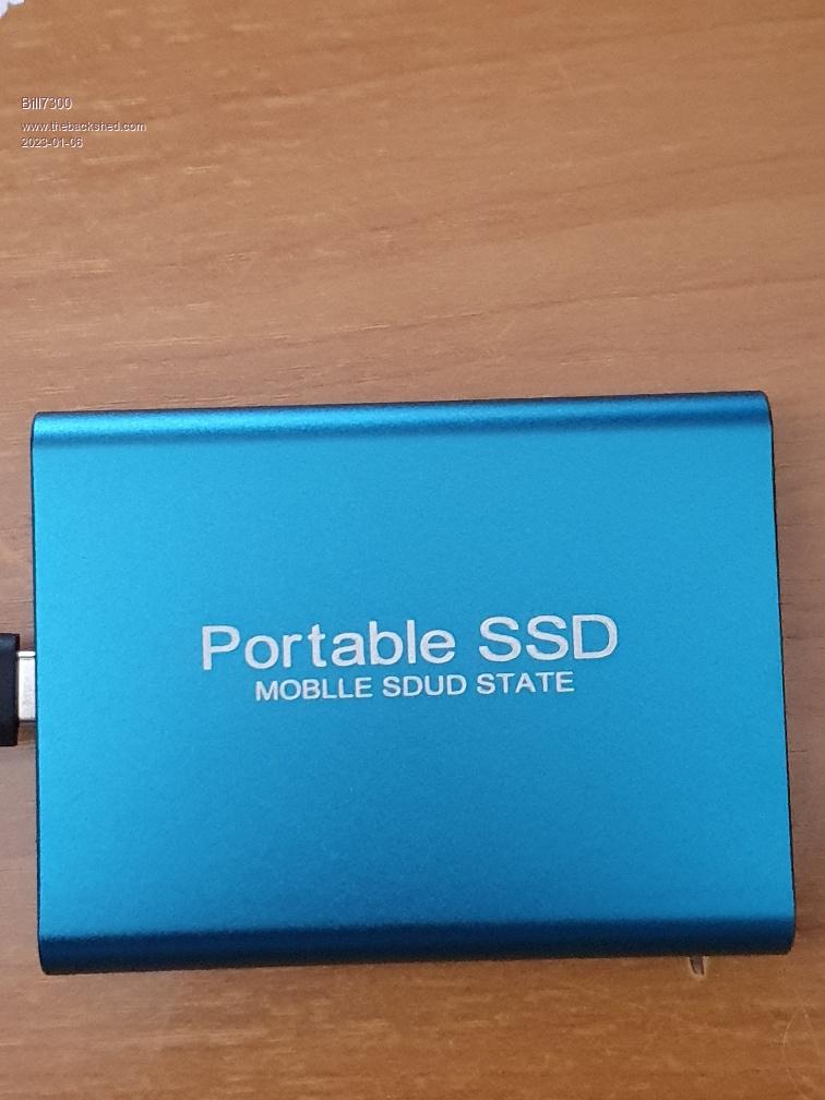

Not quite the same device but one here is very similar. The description under the "Portable SSD" should have been a clue. Obviously "MOBILLE SDUD STATE" looked sufficiently close to "MOBILE SOLID STATE" to that non-English speaker.

  Bill7300 said  Not quite the same device but one here is very similar. The description under the "Portable SSD" should have been a clue. Obviously "MOBILLE SDUD STATE" looked sufficiently close to "MOBILE SOLID STATE" to that non-English speaker.
Ha! Ha! ... but it's not funny really :) It's bad!

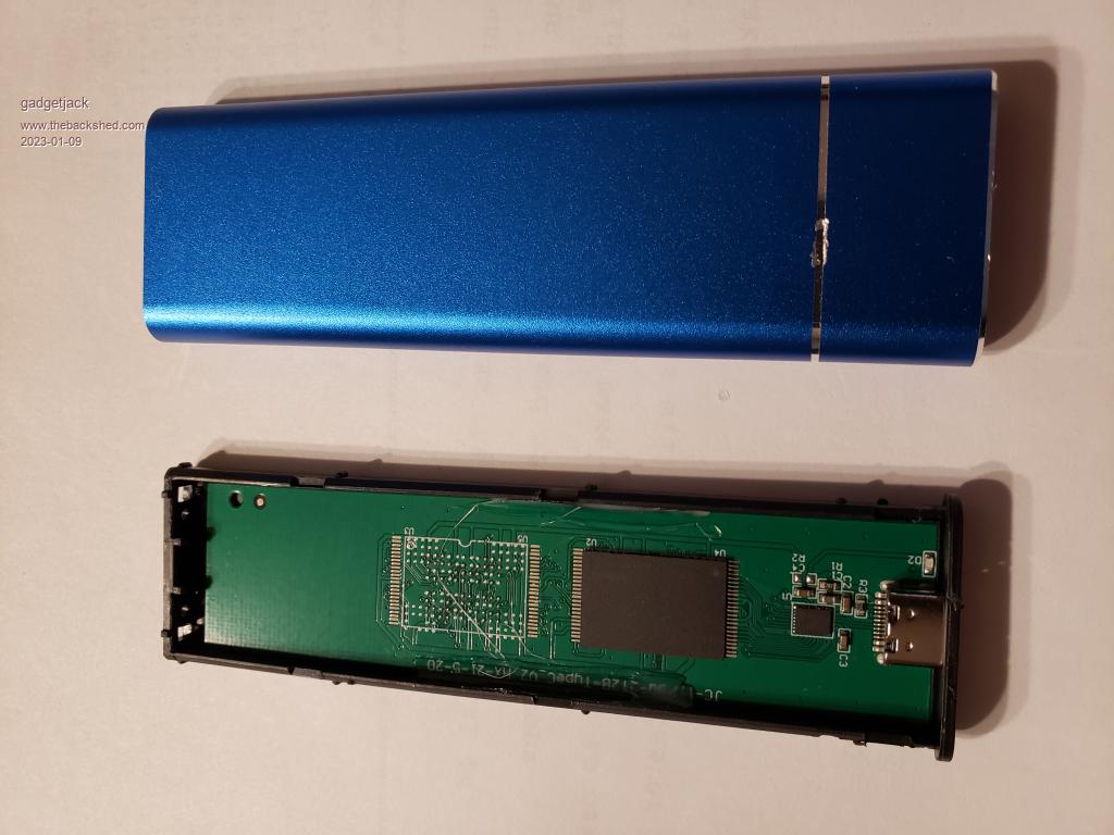

Posted: 11:26pm 08 Jan 2023
I remembered getting one similar to this as a present a few months ago. Was told it was 2 terabyte. I laughed and put it on a shelf. After reading this thread , I dug it out and tested it for a laugh. Sure enough it says 2 terabyte , but fails after about 32 gig of testing with fake finder software. And very SLOW reading. Says bluetooth 3 but I dont think so.
SDUD is right. Definitely a DUD!
