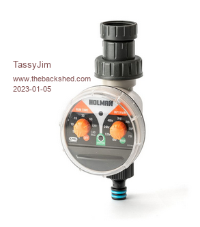

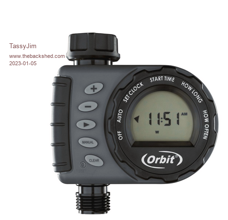

I have some garden timers that run on 3V. They use a rotary ball valve driven by a small motor. The timer part is stuffed so I intend to repurpose the motor/valve "eventually". They rely on physical limit switches so not sure about the life-span.
A trip to the garden centre might give you some inspiration. The voltage used varies a lot.
This one is 3V
This one is 9V
My 3V ones are similar to this 9V one.
And I know there is at least one Bluetooth one that is 6V.
Prices vary from worth butchering to ridiculous.
You are right about the solenoids, some require a low holding current, others are latching. Being packaged for the gardener, the details are limited.
