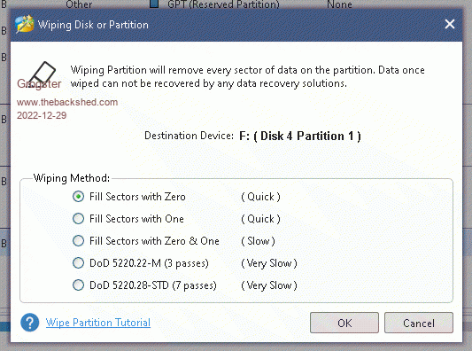

Rather then destroying them and throwing them in the skip, I was thinking of flattening them and selling them off for $1 reserve each, however, I need to be sure that they have been totally erased.  A quick format is not suitable for this.
MiniTool Partition Wizard has a tool called WIPE DISK, and you can select from a few different options including fill with zeros, fill with one's, fill with alternate zeros and ones, 3-pass wipe and 7-pass wipe.
Which one would the members here suggest?
I am thinking of the simple fill with zeros(quick) option.
Not really worried about each one maybe taking several hours to complete - I will just do one per night, and leave it wiping the drive while I sleep.
There is nothing absolutely mission-critical on any of the drives - they are just old system drives, and many of them are just old media storage drives from various server builds over the years.  NASA or CIA/FBI levels of data destruction are not required.

The multi-wipes are a waste of time - completely unnecessary unless you expect the security services are after your data.
Yes go for the zeros (or one or any pattern) :)

Ah....  DBAN is your friend. :)  Not a boot CD or USB stick to be left where your enenmies can find it though.
Multiple wipes move the head between track accesses. That way, because the head doesn't always get the track *exactly*, it wipes almost all the area between the tracks, not just on the track centre lines. Very good for secure wipes.

  Mixtel90 said  Multiple wipes move the head between track accesses. That way, because the head doesn't always get the track *exactly*, it wipes almost all the area between the tracks, not just on the track centre lines. Very good for secure wipes.
Maybe... but who needs that security (even if it's true)? Who would put in the effort to try to recover the data (even if it's there)? Why?

Not many people need it. :)  I've been given works PCs in the past providing I can assure them that the HDD is wiped. A read of the DBAN info and leaving it to run overnight has been easily enough to convince the accounts department that their data has gone (even though there's no actual guarantee with DBAN). There's no undelete after that - it's basically a brand new HDD so it has to be formatted from scratch.

  JohnS said  The multi-wipes are a waste of time - completely unnecessary unless you expect the security services are after your data.
"Simple Overwrite (1 pass)" overwrite method writing 0s or random data does the Job.
