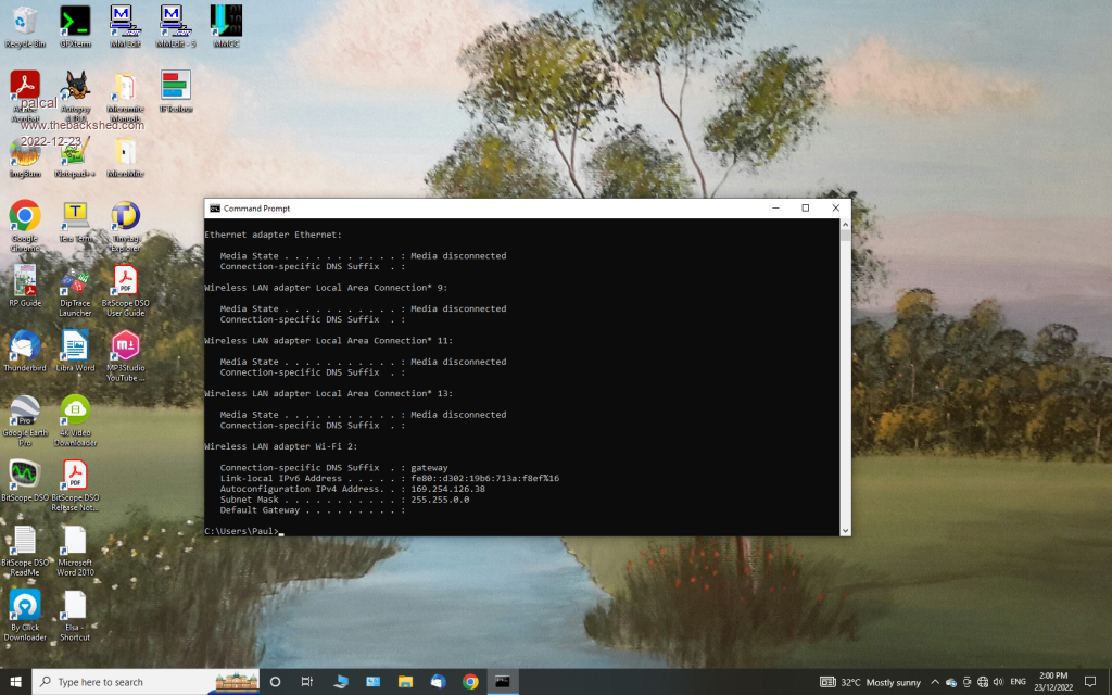

The laptop is connected and works OK. The workshop computer connects to the wifi but has no internet and when I trouble shoot I get the message 'Invalid IP configuration'
Running ipcofig gives me
Posted: 06:45am 23 Dec 2022
Your adapter has ended up with a default address meaning it couldn't find the modem.
From a command prompt
IPCONFIG /RELEASE
IPCONFIG /RENEW
you might need to add ALL to either or both the above commands.

Posted: 09:32am 23 Dec 2022
Hi Paul,
The 169.xx.xx.xx address is a windows default IP address when no IP address was provided by a dhcp server.
In your router is it set to provide a DHCP address?
Is there some other setting in your router like limiting the number of ip allocated ?
Maybe factory default the router.
Can your PC actually see the SSID listed?
Is your PC expecting to run in a domain?
Is the PC trying to run some VPN software or have some wifi manager running?
Try uninstalling the wireless device (in device manager) and then refreshing the list to reinstall it.
Good luck.
