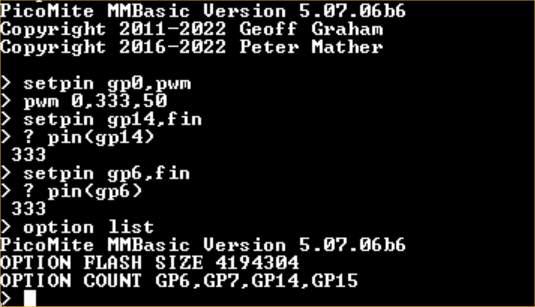

Posted: 07:54am 22 Dec 2022
Are you connecting the correct pins?
Edited 2022-12-22 17:59 by matherp

Posted: 10:12am 22 Dec 2022
OK found the cause. It happened between 5.07.05RC6 and RC7 and is to do with a change I made to the keyboard handling. The problem only arises when OPTION KEYBOARD is set (default on the VGA version) hence seeing it on the VGA version. Can replicate on the ordinary version by setting OPTION KEYBOARD UK
Now just need to fix
UPDATE: I've replaced the firmware in the latest download, please re-download and test
Edited 2022-12-22 20:45 by matherp
