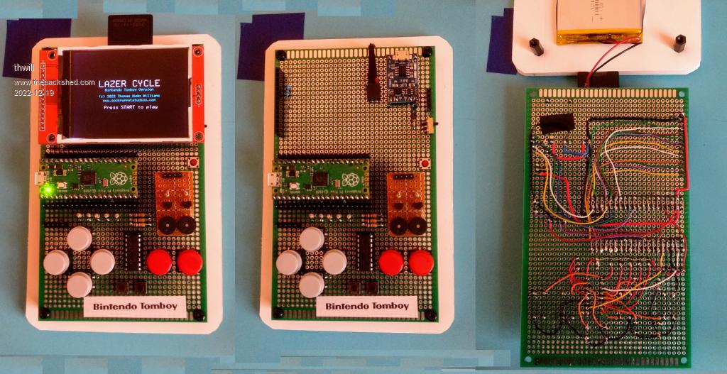

Hi folks,
I had planned to defer sharing until I had a schematic and maybe a video made, but I failed to be that patient:
Thanks to everyone who helped, even if they didn't know that they were, especially @Volhout (audio), @Mixtel90 (I borrowed the backpack schematic for much of the layout) and @Turbo46 (encouragement).
Apologies for the dreadful photo lighting / editing.

Looks really good..
On my pico system the pico is under the screen ( like the micromite backpack )  Just shows how versatile these things are..
Well done....
Ian

With integrated NES controller... WAUW...
Nice work Tom !!
Looking at the pictures, I guess the battery is under the display, not leaving much room for the picomite...
When possible, show a video of the Bintendo Tomboy in operation...

  Volhout said  With integrated NES controller... WAUW...
An affectation, the Pico has enough GPIO that I could have just wired up the buttons directly.
  Volhout said  Nice work Tom !!
  Volhout said  Looking at the pictures, I guess the battery is under the display, not leaving much room for the picomite...
The battery is under the protoboard taped to the piece of foamboard that currently serves as the "enclosure". I think there is space under the screen to squeeze in the PicoMite, a micro-sd, the charger module and the amp module (once I've chosen one - the current "buzzer" setup is just a temporary expedient to "complete" this prototype) and then compact the whole device onto a 100x100mm PCB - my next step with the h/w once all the bits arrive.
  Volhout said  When possible, show a video of the Bintendo Tomboy in operation...
That's the plan, but I want to put in the extra effort to make a proper video (rather than a quick single-take recording) so as to potentially attract a wider audience.

You're quite welcome to do so! :) I'll send you my SL6 file if you like and you can have a go at modifying it. It might give you a good start.
I'd suggest moving the display slightly further "up" the PCB, although you may need to find a thinner speaker.sounder to do so. An idea there might be to use one of the thin piezo elements (the flat ones) and glue it to either the bottom of the case or, if tracks allow, to the bottom of the PCB. The SD card might be able to go on the underneath of the PCB, underneath the Pico (which is surface mounted).
Getting the height of the display correct to fit the case will require a little thought.
EDIT
I think this needs:
a) a longer connector for the display in order to get it close enough to the box lid. It may be possible to use a through-hole PicoMite with this.
b) a daughter pcb on pillars to get the buttons close enough to the lid of the box.
c) the display moving "up" as far as reasonably possible to make more room for the buttons at the bottom.
d) as far as I can tell from looking at a box, it would be possible to fit the SD card holder under the PCB (but probably not the battery).
e) it *might* be possible to fit a SMD Pico under the PCB, which would make plenty of space under the display for the battery. I've not measured anything.
All of these ideas mean a (more or less) complete change of layout so there's plenty for you to do. :) Note though that at the moment the centre line of the display is very close to the centre line of the PCB and box so there's no need to change its horizontal position.

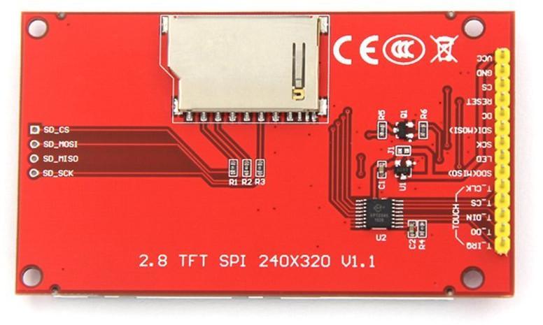

Just received one of those displays (ILI9341). I bodged up the SD Card part and works great.
Do you have a schematic or just a list of Pico pins to the display connector you could please share?
I searched and while there was a huge discussion about ILI9488 not working, it only referenced the ILI9341 controller which has different pin designations.
A picture of the connections on my board;
Thanks in advance for any help from the group.

  Quote  Do you have a schematic or just a list of Pico pins to the display connector you could please share?
manual "Example LCD Panel Configuration"
Hans
Joined: 18/10/2022
Posts: 117
Posted: 04:23am 20 Dec 2022
Thanks I knew I saw the details somewhere but I just could not remember where. Page 47 is exactly what I was looking for.

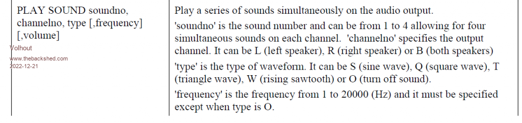

I believe that the PLAY SOUND is used to play sine waves but I see that 'TYPE O' and 'TYPE S' are used but I cannot find out their meaning in any manual.
Anyone?
  CMM2 manual said  PLAY SOUND which will generate an output based on a mixture of sine, square, noise, etc waveforms.
Maybe type O is 'off', type S is sine but I don't know? Can one channel have two or more types of wave form or do you use different channels for the different waveforms? I hope that type 'S' is not square wave because this post is largely meaningless.

The picomiteVGA manual shows your sound options...

Clearly I do not have the latest manual (I thought I did) but it's not in the CMM2 manual? Found it in the Draft PicomiteVGA manual thanks.
Posted: 08:37am 21 Dec 2022
  Quote  Clearly I do not have the latest manual (I thought I did) but it's not in the CMM2 manual?
Page 99 (Adobe page) of CMM2 manual as downloaded from Geoff's site
