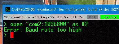

Posted: 12:31pm 13 Dec 2022
I get an expected error message:
"1036800 is invalid (valid is 24)" - is definitely an odd error message, and I suspect it is a bug of some sort.
What are you using?
170 MM2 chip?
MM+ chip?
ARMmite?
PicoMite or PicoMite VGA?
My message came from a MM2 on a 170 chip, simply as I happened to be writing something at the time I checked the forums, and everything was all hooked up, so I was able to do a quick spontaneous test.

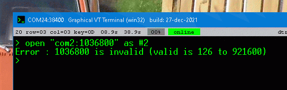

EDIT: Just tried this on a PicoMite, and I get the following error report:
So, it looks like you've maxed out the com port speed.
Edited 2022-12-13 22:35 by Grogster

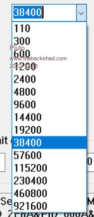

These are the standard speeds.

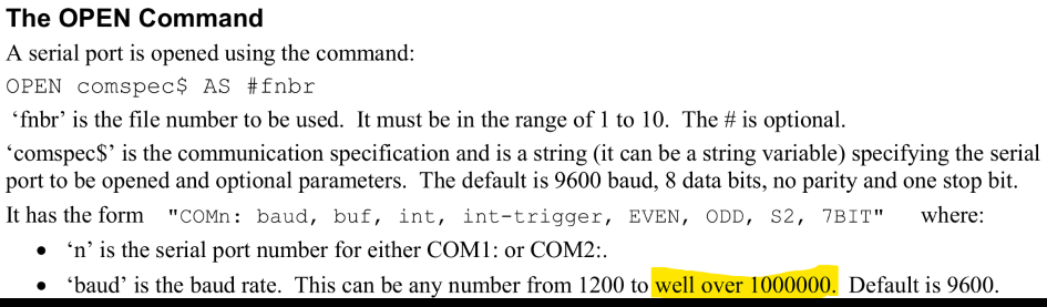

User manual: "Well over 1000000"
Posted: 12:56pm 13 Dec 2022
we'll consider it theoretical
was a little bit surprised in Grogster's screen grab, minimum baud is 126... 110 was common on a lot of older stuff, and while I agree it isn't common now, I would have imagined compatibility just because...  Tinkerers beware!
