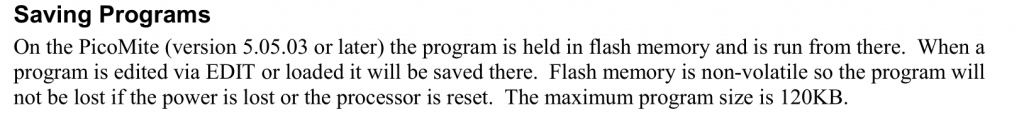

120K? Just type memory at the command prompt.

I Understand that I can use FLASH CHAIN.
The manual states that the maximum program size is 120KB.
I take it to mean that this does NOT include the flash slots.
Is each flash slot also 120KB in size?
Sorry if I didn't make myself clear on the original post.
Posted: 02:09pm 12 Dec 2022
Earlier manuals say 124KB for flash slot & for program. I think both changed to 120KB.
(If the FLASH slot was bigger than the program size the extra would never get used, and if smaller you couldn't save a max-sized program...)
