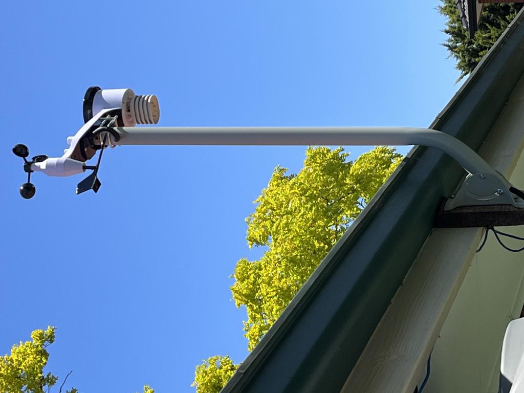

Whilst it is 'up the pole' it is not difficult to bring it down again, The pole I purchased is a very nice unit that can rotate down 90 degrees to make the unit accessible with a small step (see attached)
All 3 sensors are within 10mm of each other and are located in the `bee hive' section under the rain collector in the above picture.

I still probably wouldnt go to the effort of pulling it down (then stripping the unit down to access the sensors) and I don't have access to a know good thermometer either.

I don't know why the image is rotated but You can make out what I mean about the pivoting pole.

What bothers me is that in the Australian summer, that "bee hive" will heat up to who knows what? and as noted by Jim you will get some pretty funny results.
I found the best place was under a rainwater tank mounted a couple of feet above ground and protected from direct sun light but open to air movement. I could then get believable results using a 18B20.

I was wondering how things would be on the 45 degree C days and also how the plastic shell, especially being majority of White, would handle the sun.
Whilst the bee hive is no where near as good as the stevensons screen Jim mentioned , the way it is designed gives a reasonable amount of protection due to the overlapping effect of each shell.
