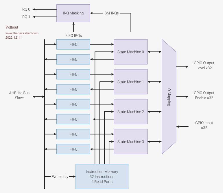

Block diagram of a PIO: the 4 state machines and the FIFO's are shown. As is the access to the IO.
There is much documentation in the RP2040 datasheet (whole of chapter 3) on the PIO, that I often consult. You can find the datasheet on the Raspberry Pi web page.
The RP2040 has 2 PIO blocks (so in total 8 state machines) but we will only experiment with PIO block 1, since PIO block 0 is used for generating VGA video in the VGA picomite ("boot to basic computer" on Geoff's website). And the VGA picomite is a perfect platform to learn through execersize.

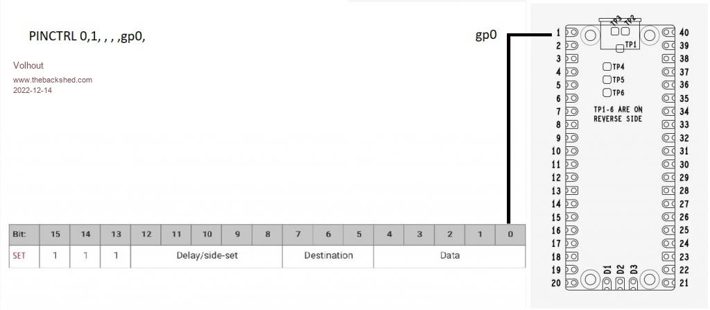

f/ the lowest pin for SET      (must be set to GP0)
g/ the lowest pin for OUT      (not used here)
so PINCTRL (0,1,,,,gp0,)
This tells the state machine there is 1 SET pin it can use, and the SET pin is GP0.

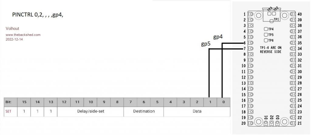

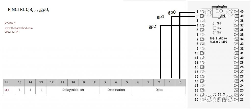

If you change the "1" to a "2" the state machine can use GP0 and GP1 (2 succesive pins).

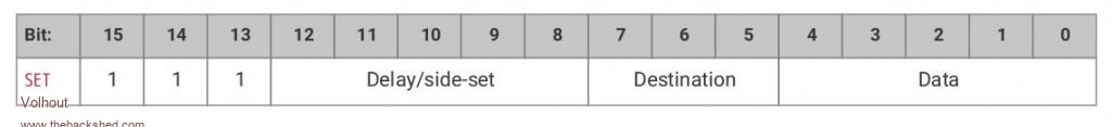

The state machines have a SET instruction:
The instruction can SET up to 5 bits (the DATA field) in multiple destinations (DESTINATION field). One of them being the IO pins (DESTINATION = 000). The DELAY/SIDE SET field will be ignored for now (value 00000). More information about the SET instruction can be found in the RP2040 datasheet (chapter 3.4.10), which I highly recomend reading.
So the instruction will read 111 00000 000 DATA
Since we have 1 IO pin configured we can fill DATA with either 00000 (set pin to 0) or 00001 (set pin to 1). The other bits have no function with our configuration. In case we woudl assigne 2 IO pins, as hinted above, we could write 2 pins with 00000, 00010, 00001, 00011.
Our program takes shape...
111 00000 000 00001  = 1110 0000 0000 0001 = &hE001  SET PIN HIGH
111 00000 000 00000  = 1110 0000 0000 0000 = &hE000  SET PIN LOW

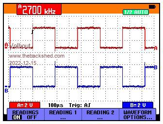

The first chapter was a bit of dry because we needed to cover quite some ground. Next chapters will be smaller and contain less information. Will be more focusing on practice. So you will need a picomite, a breadboard of some kind (wires) and basic IO elements, such as some leds, a buzzer/piezo/speaker, resistors and switches.
Speaking of buzzers. If you run previous exercise, connect a piezo/buzzer in stead of the LED to GP0, and experience the tone (666Hz).
As to Grogster: don't be shy... the PIO code is loaded into RAM (program memory of the PIO), and will not damage your pico in any way. Just unplug and all is gone.
The program in the first post will be used as a template for further exercises, each time modifying it a bit.
For this who want to challenge themselves: try if you can get the same 666Hz tone out of pin GP2. Hint: you do not need to change the PIO program for that, just the configuration. In next chapter the solution will be given...

chapter 2
- explaining the exercise with pin configurations
Last chapters exercise was about moving the 666Hz tone from pin GP0 to GP2.
You did not need to change the actual program, but only the configuration.
The starting point was the GP0 configuration, that links GP0 to bit 0 of the SET command.
You can assign more pins to the SET command by increasing the number of successive pins
Or different pins, by selecting a different starting point
Knowing this the simplest answer is to assign 1 pin, named GP2.
And of coarse, you need to assign GP2 to the PIO1 in a SETPIN in MMBasic.

For #2 this is all I can manage. It works after a fashion but the phase shift is a little over 180 deg.

All attempts to invert the output within the PIO program failed.

You have found a good solution !! Having 2 state machines run identical code, and start the second machine 180 degrees out of phase (the Do While Pin(gp0):Loop waits for GP0 to get low, and then starts the ssecond state machine, that starts with a setting gp1 high). Excellent thinking. The phase error you see lies in 2 things:
- the delay in executing the MMBasic "Do While" and "Start PIO", but more so the PIO instruction that sets the GP1 port output. That is one instruction (with a loop of 4 instructions long) giving 90 degrees phase error.
You could improve that behaviour by increasing the clock for the PIO, and adding delay in all instructions except for the one that set's output. But the phase error will never vanish.
The solution that you where originally trying (I guess) and that did not work is attached below as a ZIP. I do not want to "publish" the solution yet, to give others the chance to work on a solution. Unless they cannot resist, then they must unpack the ZIP.
Without details from you I estimate you did not get any signal on GP1. That symptom will be explained in the next chapter, and will be the introduction for the PIO EXECUTE command...( lifting part of the vail)....

That is far superior. The PicoMite manual doesn't go into the details and the RP2040 data sheet fries my tiny brain.
" I estimate you did not get any signal on GP1"
That was the main problem, but even if I had overcome that I couldn't see how to invert the second output.
