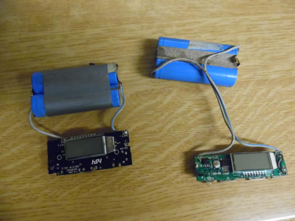

Posted: 07:01pm 06 Dec 2022
These are cheap. 1A and 2A usb out. Mini usb to charge and a lcd battery level

Many thanks Peter, it appears that exactly the cell I want exists 405080 .
Now charging circutry, I've got some O3962A modules (looks like this https://www.aliexpress.com/i/32963400277.html) that I can hopefully scavenge from some of @lew247's defunct weather station PCBs - they look suitable to me, but what do I know ?

  thwill said  Now charging circutry, I've got some O3962A modules (looks like this https://www.aliexpress.com/i/32963400277.html) that I can hopefully scavenge from some of @lew247's defunct weather station PCBs - they look suitable to me, but what do I know ?
Edited 2022-12-13 00:35 by thwill
Posted: 09:50pm 12 Dec 2022
I observe that half of this 03962A unit appears to be "protection circuitry", that seems to be duplicated (even looks like the same pair of ICs) in a sliver of PCB that is already attached to the LiPo, is that going to be a problem?
