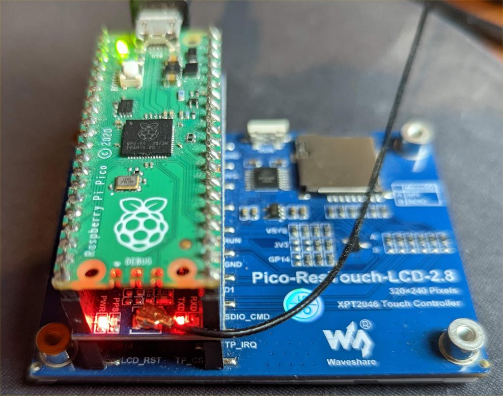

Using the Pico board with the Waveshare 2.8" display  and the Waveshare Pico GPS  it is possible to make Geoff's boat computer plug and play.
Pico compatible code
BoatComputerV6.zip
Changes to Geoff's code are minimal to match the Pico with one small but important functional change which is to accept GNRMC as well as GPRMC
OPTION AUTORUN ON
OPTION LCDPANEL ST7789_320, RLANDSCAPE,GP8,GP15,GP9,GP13
OPTION TOUCH GP16,GP17
GUI CALIBRATE 0, 3927, 195, -895, 650
OPTION SDCARD GP22

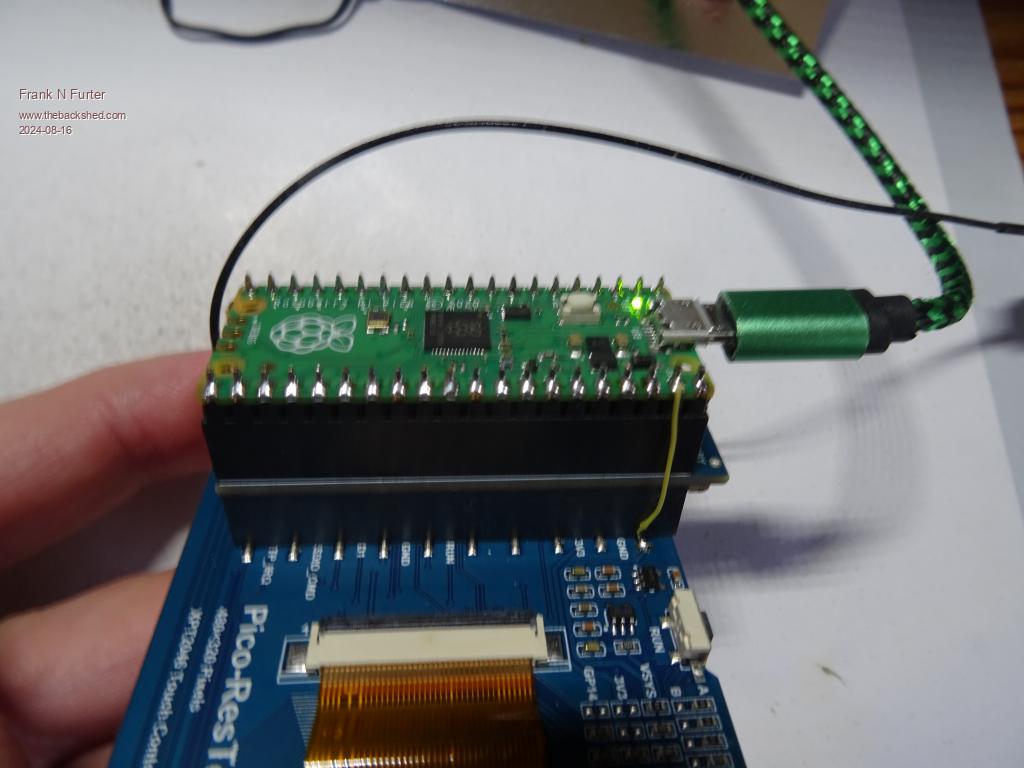

Posted: 08:48am 16 Aug 2024
Hello everyone,
I am trying to get the project to work on a Waveshare 3.5" display display. This display has an ILI9488W chipset.
If I only plug in the PicoMite, the display works perfectly, if I plug in the GPS, the display remains black and GUI TEST LCDPANEL does not show anything.
WHY???
I have tried the last official firmware V5.08.00 and the current beta firmware V5.09.00RC5.
Here are my options:
PicoMite MMBasic Version 5.08.00
OPTION COLOURCODE ON
OPTION LCDPANEL ILI9488W, RLANDSCAPE,GP8,GP15,GP9,GP13
OPTION SDCARD GP22
Can anybody help me???
Frank
Frank N. Furter
Joined: 28/05/2012
Posts: 1150
Posted: 09:43am 16 Aug 2024
Ok, I have found the error!
The contacts that Waveshare used on the GPS are obviously too short!!!
In addition, too much solder was used, which led to the contacts making even worse contact.
An additional wire to VSYS solved the problem:
I also had to make the change in line 151 so that the program runs without errors...
Frank
