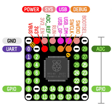

#1: the bin2str$ will send character values between 0 and 255. Was it envisioned we should avoid values between 0-32 and 128-255 ? Or is that not necessary ? Can we pass all values through the UART using the print #x and input #x commands ?
#2: @Peter... so you are translating GPxx numbers to pico pin numbers, and from there back to GPxx numbers ???? This is not really clear to me.
I understand from your text that under water (becuase we must skip ground pins) you convert GP2 to pin 4 of the pico, and size 4 (pins 4,5,6,7). But then (deeper under water) you have to translate again to the GPxx to reach the correct IO registers inside the RP2040. Sounds not very logical.
Confusing since Tinine is not using a pico board, but a board that has ground on different pins. And he is/I was/ under the impression that when using GPxx numbers you distance from the board layout of the pico, and use the RP2040 reference.

As with all the MMBasic family the I/O is based on the physical pin no.s and in the case of the PicoMite this uses the Pico as the reference layout. To make things easier for the user I have allowed the use of GP no.s but these are immediately translated internally to the physical pin no.
Tinine's port function could equally be PORT(4,4,9,4,14,4). PORT(4,6) will give the error "Invalid input pin" as it tries to use GND pin 8 as an input
