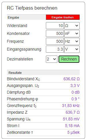

in German but I think you ll get it:
RC Low Pass
cheers
Mart!n

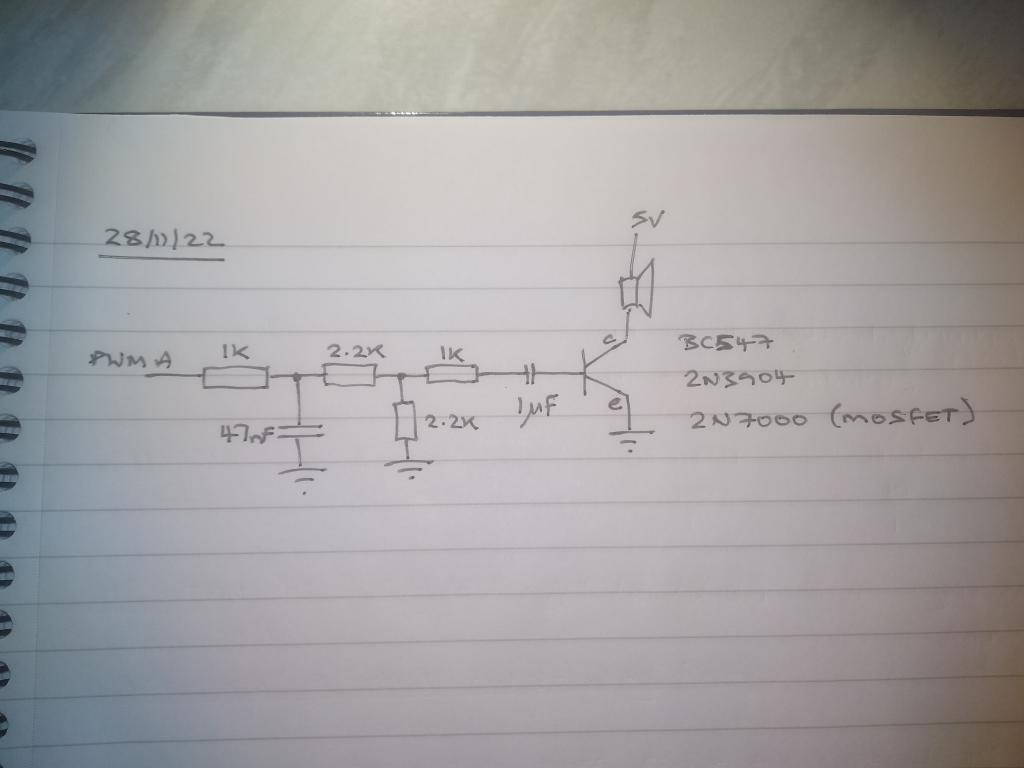

You should have Geoff's R/C network in front of this. You may also need a small resistor in series with the speaker if the transistor gets hot (it shouldn't). Note that this is *very* crude and can be improved a lot by adding bias resistors.
Posted: 01:32pm 28 Nov 2022
Hi folks,
Yes, I know the sound is going to be crap, but I'm hoping it is good enough for a bit of prototyping using components that I have.
@Mixtel90 if I do as you suggest verbatim then I end up with this, which I suspect is not what you mean ?
And assuming you correct my schematic will any of those transistors do the job ?
Apologies for needing spoon-feeding on this; I was learning some basic electronics but then got hijacked by the Colour Maximite about a month in.

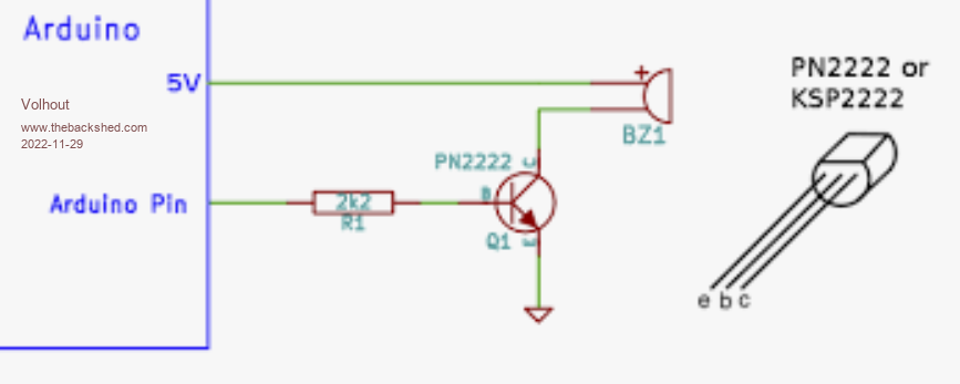

The data from the Aliexpress page looks to specify a 2700Hz buzzer operated from 2-5Vdc pulling 40mA current. So you need not drive it from a PWM. It will generate 2700Hz if you connect it to 3.3V. And it will draw 40mA.
You only need a IO pin and a FET or transistor to drive it ON and OFF.
Quick check: connect + pin to 3.3V and - pin to GND... and shiver...
Driver circuit (will work with 5V and 3.3V)
Edited 2022-11-29 02:23 by Volhout

Posted: 04:27pm 28 Nov 2022

Posted: 11:31pm 28 Nov 2022
OK, so they are active buzzers and they work fine (with PWM) using Volhout's circuit from above with the PN2222 swapped out with the BC547s that I have.
I even played a 2-channel version of "The Entertainer" on a pair of them using the PWM command, it was an experience not to be forgotten .
But I get Sweet FA (with or without the low pass filter from the PicoMite manual) if I use the same setup with OPTION AUDIO, and PLAY TONE or PLAY SOUND. What detail am I failing to grasp ?
