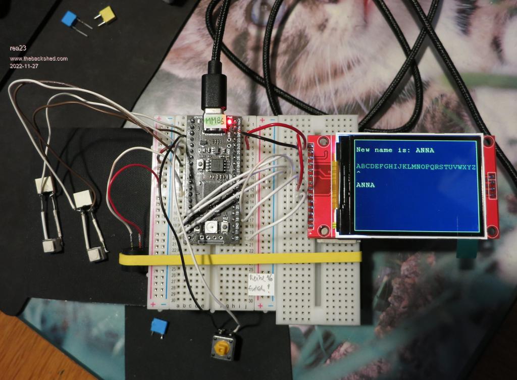

Hi
A short text, e.g. a name, is to be entered on a 2.4" display without touch screen. One possibility is shown in the listing. Maybe someone has a more elegant solution for this?

Edited 2022-11-27 21:32 by rea23

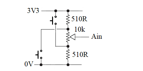

Posts: 3418
Posted: 08:36pm 28 Nov 2022
A button can be added to the pot. input without using an extra pin.
Add resistors (about 1/10th of pot. value) between the top and bottom ends of the pot. to the rails and put the button from wiper to ground. The bottom resistor ensures voltage can only reach zero when the button is pressed. The top resistor prevents a short if the button is pressed while the wiper is at the top.
A short press enters the letter and a long one enters the name, as in the above program.
Edit
Forget that.
Two buttons can be added to the pot. input without using any extra pins. Use the second to delete the last letter.
The top button inputs 3V3 and the lower 0V while the pot goes from 0.16V to 3.14V.
Edited 2022-11-29 17:23 by phil99

Using Peter's insight and adding provision for a second button (top one in the above diagram) to delete the last letter.
It should work as you intend with your current wiring. The extra lines should not matter.
' Text input with poti (TimD and phil99)
' ADC0, 1k-10k-1k gives (measured):
' 0.2790...3.0080 V over poti
' Switch down on lower R1k: 0.0130 V
' Poti works ok ==> shows A...Z
' Newname shows ??? instead
SetPin GP26, AIN                      'ADC0 at pin31
' !! inverted colors because of "false" driver for LCD!! Take RGB values
Const black_= RGB(255,255,255)        'black inv.
Const green_= RGB(255,127,255)        'green inv.
Const yellow_= RGB(0,0,255)           'yellow inv.
Dim letter As string length 1         'letter for name
Dim newname As string
newname = ""
CLS black_                            'display black, iRGB of (0,0,0)
Box 0,0,320,240,1, yellow_
Font 2, 1
Again:
 NewLetter = 0 : finished = 0
 mvolt=Int(1000*Pin(31))             'millivolt
 If (mvolt > 220) And (mvolt < 3100) Then   'Read letter if no buttons pressed
  diff=3008-279                       'measured min/max
  du=diff/25                          '26-1 between
  u=Int(mvolt/du)-1                   'first # should be 1
  letter=Chr$(u+64)                   'A is chr$(65)
  Text 4, 100, "Letter is: " + letter,,2,, yellow_, black_  'is ok, A...Z
  Pause 100
 If mvolt < 220 Then                  'If lower button pressed add current letter
  Timer = 0
   If Timer > 1500 Then Finished = 1
  Loop While (mvolt < 220) And (finished = 0)               'wait for button release
  NewLetter = 1
  Print newname
 If mvolt > 3100 Then                 'If upper button pressed remove last letter
  Timer = 0
  Loop While (mvolt > 3100) And (finished = 0)              'wait for button release
  If Len(newname) > 0 Then newname = Left$(newname, Len(newname)-1)
  Print newname
  NewLetter = 1
Loop Until (NewLetter =1) Or (Finished =1)                'leave the loop
Take:
newname = newname + letter            '??? only, letter lost
Text 4, 16, "New name is: " + "                             ",,2,, yellow_, black_
Text 4, 16, "New name is: " + newname,,2,, yellow_, black_
If Finished = 0 Then GoTo Again
Print newname
Text 4, 200, "Saved name is: " + newname,,2,, yellow_, black_
'How to save the name? >=== long press
End
edit
got something wrong in the delete letter loop but otherwise seems ok.
Edited 2022-12-04 17:26 by phil99
