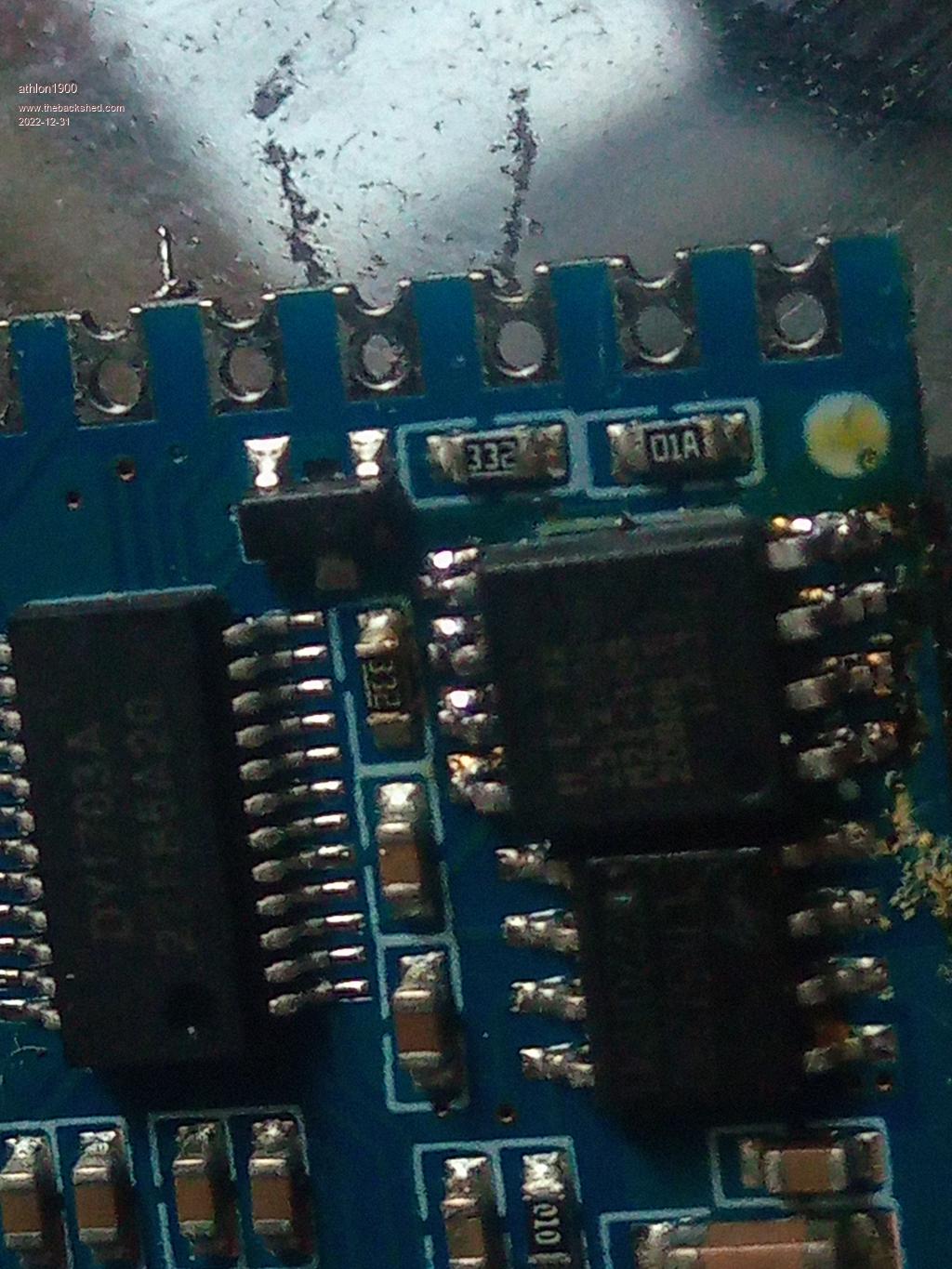

The hard-coding in the controller/playback chip might be factory set for that specific 32Mb(4MB) capacity chip, but it would not hurt to find out.
EDIT: Can't get the W25Q256 in 8-pin SOIC, it is only available in 16-pin SOIC or 8-pin WSON/WFLGA (QFN-like) package, so that one is out, but you CAN get the W25Q128 in SOIC-8, so I might get a few of those to play with.  If it worked, that would increase the file storage to 16MB instead of 4MB.
This may or may not work, but one way to find out is to.....
It is more academic then practical, as the effort to replace the FLASH memory chip on a $2 module is questionable, but there you go.
EDIT: Opps!   W25W128 is the wide-SOIC(1.2mm wider package), which would be difficult to force-fit onto the narrow-SOIC footprint, so that idea is now out.  MIGHT be able to use the likes of a W25Q64(giving 8MB of storage), but would need to check the footprint-vs-package size thing again.  Might simply not be worth the effort.
EDIT: Hold the phone.....  Looking at the module again, it would seem that they DO use the wide-SOIC flash chip, so I CAN try out a W25Q128, but not the W25Q256, as it is not available in the SOIC-8 footprint.  You can easily see the size difference on the photo of the module in the PDF.
What about this one : 32MB MX25L25645 SOP8
Seems to be pin compatible according to the data sheet.
Does it always have to be winbond ?

Found also the DY-SV8F board. Seems to be the big brother.
There is the same controller (DY1703a) and a 25Q64 flash onboard.
Think (hopefully) there is a good chance for upgrading the flash.

I have looked all over google, I cannot find ANY data on the DY1703A chip.
If any member reading this has had better luck, please can you post a link here.
Normally, you can track down even a Chinese language version of a datasheet for chip X, but in this case, I can't find anything at all.
This despite the date-code on the chip in the pictures being 201903, suggesting it was made in 2019 or 2020 depending on how you want to interpret the code.
Normally just four digits, YYWW so 19th week of 2020, but could also be 3rd week of 2019.  I could also be neither of those at all!

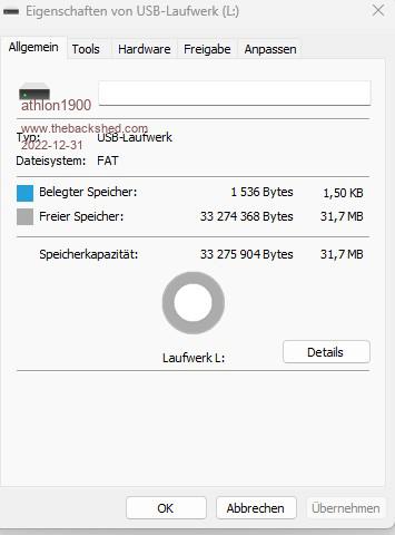

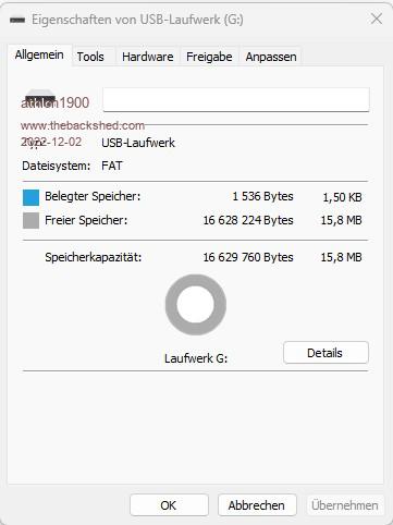

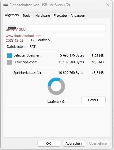

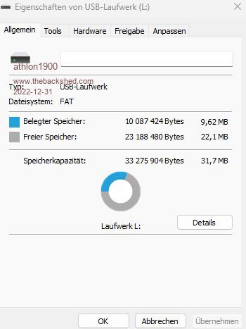

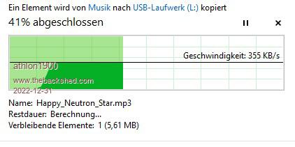

I successfully swapped the flash to a W25Q128.
What I can say is that the Mini Player behaves like a USB stick.
Windows formats the flash with FAT and then correctly shows 16 MB.
I copied a 5MB mp3 file and it works.
The copying process takes longer, since it is writing into the flash.
Next step a 25Q256 when these arrive
