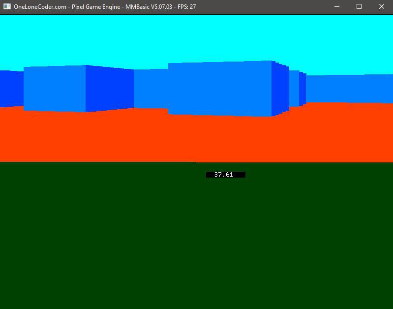

Posted: 05:09pm 22 Nov 2022
updated Version
(here in Windows)

Posts: 4395
Posted: 11:10am 23 Nov 2022
Very nice Martin, a bit slow on the poor old PicoMite but nothing a bout of optimisation, or failing that, a CSUB wouldn't fix I'm sure.
I have once again taken the liberty to use your code to continue ironing out some issues with my controller library:

Hi Tom,
sadly, I haven't found any instructions on the web yet how to compile CSubs for the Pico (Environment, compiler etc).
But maybe, I Find a faster Algorhitm to do the casts in Basic.
On the Website, where the BubbleDemo came from, is a Algorhytm with a different approach.
For Now, you'll get it a little faster by lowering the resolution
change in the  drawRays3D sub
than it does less Scans per Frame
For r=0 To 119
to
For r=0 To 63
and  the Part
Box xstp,(hv>>1)-LineO,1+hh/60,Lineh,,wcl,wcl
Inc xstp,hh/60
to
Box xstp,(hv>>1)-LineO,1+hh/32,Lineh,,wcl,wcl
Inc xstp,hh/32
PS: Your Version works well, as long as I use Port A for Atari or NES Controller
Edited 2022-11-24 00:41 by Martin H.

Maybe someone else will have better luck.
led
Hi  Led,
in my working Version I didn't use the Distance Function anymore, cause every Function call is timeconsuming .. So i do the pythagoras calculation within the Program, two times
Also, to speed things up I try to use "IF THEN" in the Loop only if it is really necessary.
That's why some adventurous lines come out like :
Inc ra,P2I*(Ra<0)-P2I*(ra>P2I)
to keep it in the Range of 2 Pi
Another way to optimize would be to rewrite the Algorythm to use degrees instead of radius, so I can convert the "floating Point Calculations" to Integers.
the best CSub would have to contain the whole Raycast Function like
Cast PX,PY,PA,Casts
that returnes the "casts" number of distances in an Array which can be read in the Draw_Wall Sub. :-)
As you can see, there is still a lot to optimize.
I have to go to the office now, but I'll think of something.
Cheers,
Mart!n
Edited 2022-11-24 16:25 by Martin H.

Hi Tom
today I found the Time to speed it up as much as I could.
so for PicoMite VGA its ..ok (5-10 fps)
raycast-pmvga.zip
but it does not run in MMbasic4W (dosnt know the "ON" Command.
and keyboard Controll does'nt work on both Pico and Windows.
Edited 2022-11-26 01:35 by Martin H.
