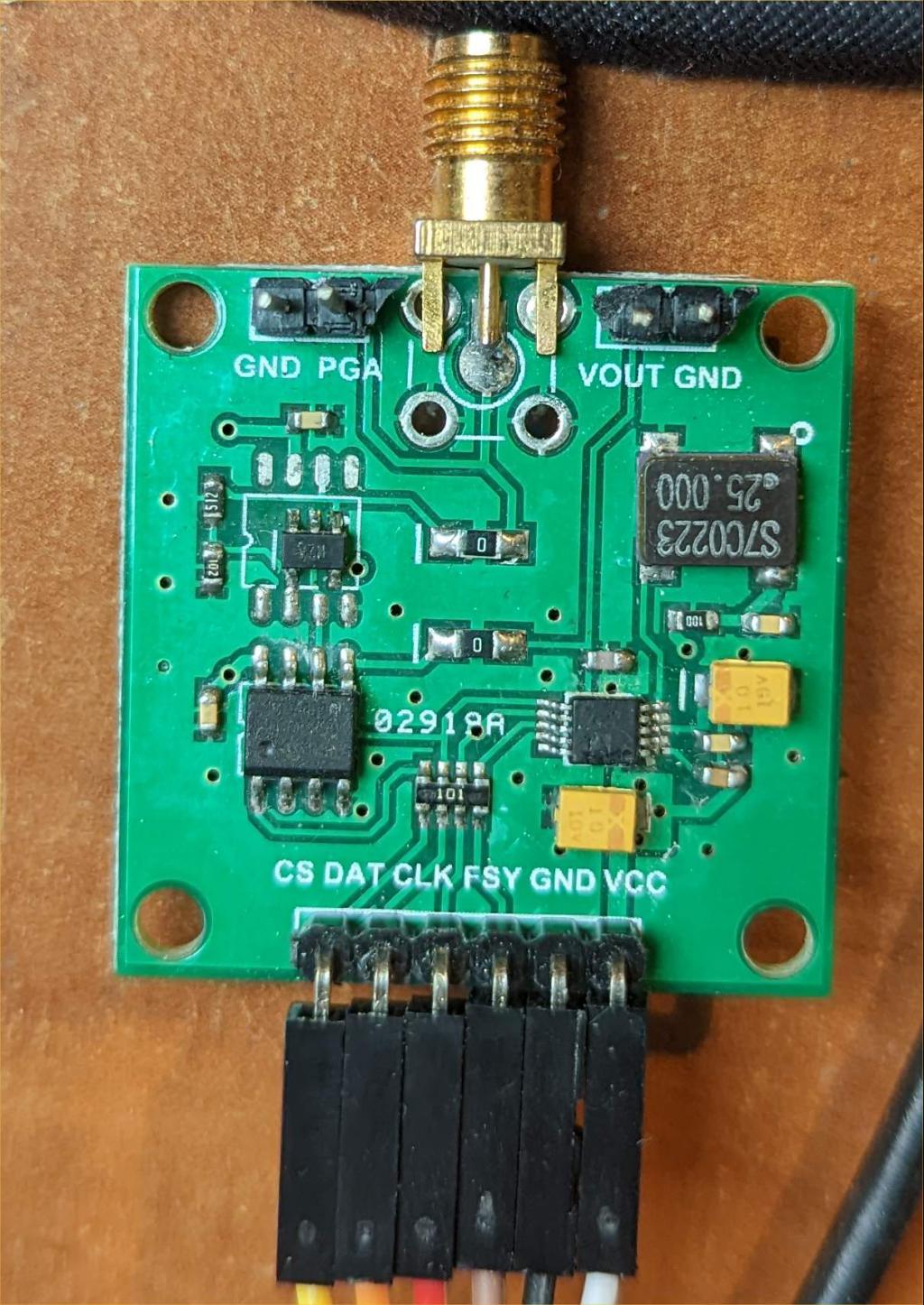

To make this work you need one of these AD9833 modules. It must be this version which has a variable gain output stage.

The output of the AD9833 is of course single ended so the waveform looks a bit odd but the radio picks it up fine with a short wire connected to the PGA pin. This is a 50 ohm output and I'm sure the "analogue" experts can suggest a suitable circuit to improve this.

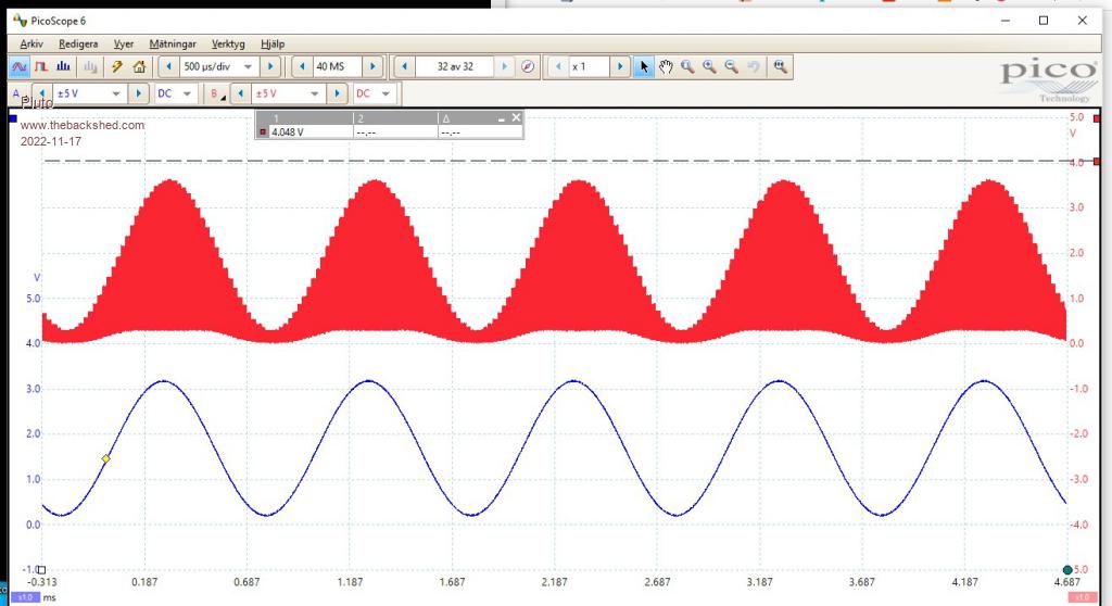

I build the project as you described with exactly the same AD9833 module as you have.
The module outputs the carrier wave exactly at the correct frequency. I have a signal generator (a la Geoff) connected to the analog input pin 34 (ADC2).
The problem is that I am not able to get any modulation on the carrier wave.

Try just connecting pin 34 to 3.3V and then to GND you should see the modulation changing. If not check pin 34 is working as a simple analogue input.
UPDATE
Just noticed you haven't got OPTION AUDIO set. This is needed to create the interrupts. You can also test by replacing PLAY WAV "" with for example PLAY TONE 400,400
Edited 2022-11-17 01:12 by matherp

Thanks Peter!
Added OPTION AUDIO GP26,GP27 and a SD-card with a wav-file. I thought that OPTION AUDIO was only required for audio output.
Works now and I have just started my own broadcasting company. Hmm... it is closer to Narrowcasting. Just and just hearable inside the house.
Works now also with analog input.
This became a very nice toy to play with!
Stay tuned on 891kHz...maybe you can hear my 1000Hz signal.
