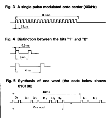

According to the data sheet, the IC uses a 40kHz carrier -- and 6 bit command words.
I think I should be OK to read / decode the existing remote.  But the PicoMite manual talks about 38kHz / 12bit for sending IR.
Ok, so the built in "sending" doesn't look like it would work -- so time to roll my own. The datasheet talks about 2msec and 4msec intervals being a "0" and "1"  -- so question:  Can I modulate an IR diode fast enough to make "0" and "1", with each pulse being 25us << that's the big question I suppose.

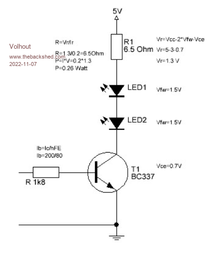

an IR driving circuit can be as this one:

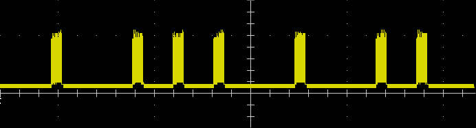

So the next thing was to dig up the 'scope:
From this, the measured frequency of the carrier is 38kHz (as expected)
The pulse shown is 100110 - which from the "1" button (if I remember correctly).  It looks like each pulse is sent word is sent multiple times  -- but from reading the manual, it appears that the device only responds to one pulse regardless of how long you hold the button.  The device then "beeps" to say it is read for the next input.
I need to investigate that more, but it looks like I can now capture the words/bits for the remote and then build upon the code here to make a custom remote.
More updates to follow.

Since the 70's there was quite a lot of development on the field of IR remote controls. It is no coincidence that Philips is already at RC6 or RC7 in IR remote control protocols.
One of the things that was missing in the early remote control receivers was AGC (automatic gain control). Early receivers had a high gain and set threshold. Current receiver modules have AGC build in, to allow for a greater range  (not only further, but also closer).
If you use a IR receiver with AGC, the gain is wide open when it receives the first burst of 38kHz light, and can cause a corrupted detection of the first pulse. Modern IR protocols adapt to this behaviour by sending a light burst ahead of the actual data, or they define the first IR burst to be longer.
Additionally modern protocols have implemented checksums or CRC's (or send the message twice, but inverted) to improve reliability.
The older systems, that cannot do this, can work around it by sending the message twice (only act when 2 identical messages have been received), or 3 times (majority decision).
This is most likely implemented in the system you have, given that te IR protocol does not have a checksum defined....

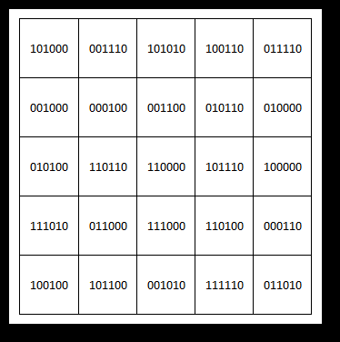

I've decoded the matrix  (I think I just wanted to post those words!!!)...
Once I set my scope up properly and soldered some temp wires to the remote control, this was quite easy - especially as there is no protocol to speak of -- press the button and the same code gets sent repeatedly until you release the button.
So, now to build a simple transmitter.
