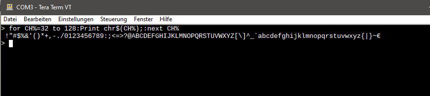

you get a Print without NL/CR if you just end your Print Statement with a Semicolon
for CH%=32 to 128:Print chr$(CH%);:next CH%
'no comment
