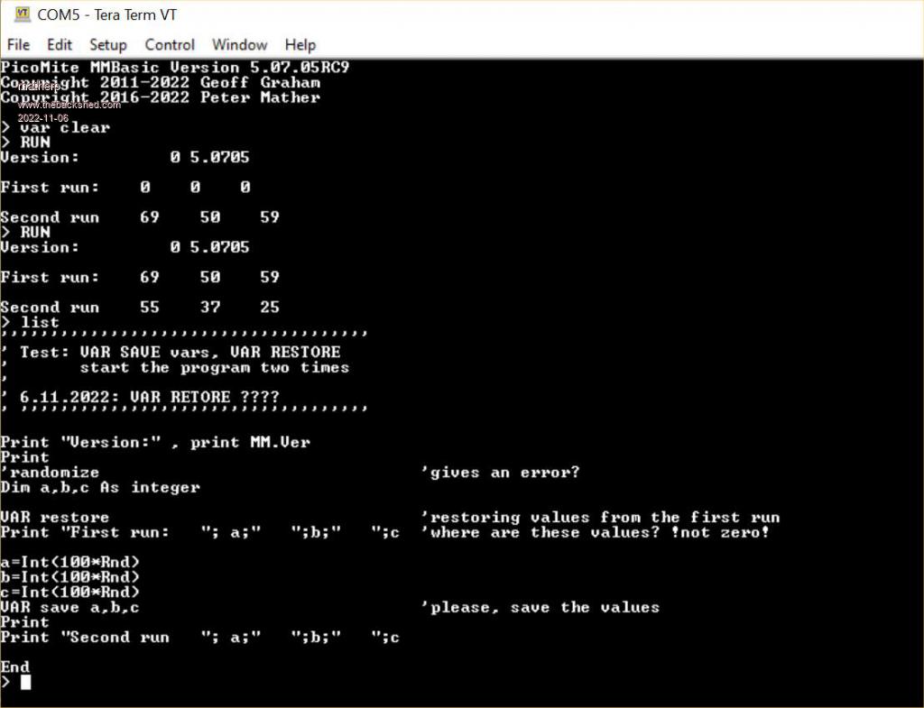

Posts: 11791
Posted: 11:02am 06 Nov 2022
Don't know what you are doing wrong. Are you reloading the program between runs with MMEdit. Tested as below using Teraterm

It is a shame. You are absolutely right. It's obviously a bad habit of mine to press the rightmost icon in MMEdit, because it means exactly what it is, "load file and run it". Once again, it's a shame. Sorry for the time you spent.
Nevertheless, with the picture, you saved the situation for me. Thank you very much.
