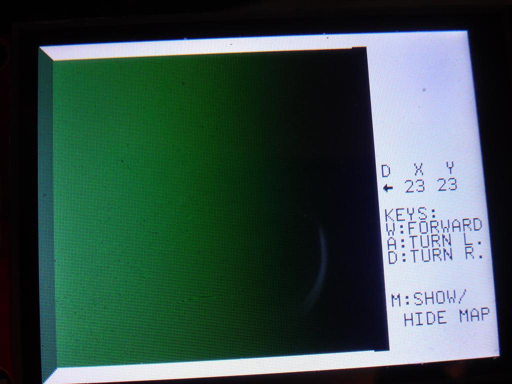

I tested it also on an ILI9341 LCD.
The only drawback is that the image of the labyrinth is a little to  small for my old eyes on the 2.8 inch display
this makes it hard to see the little green dot.

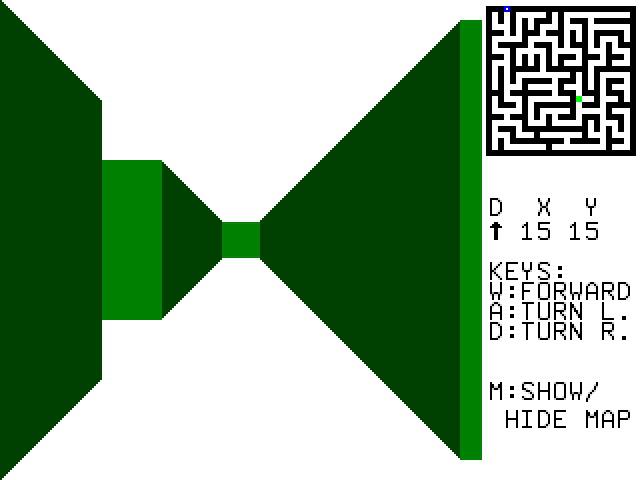

Since the walls on the sides are trapezoidal,
I can't use the box function
(x1,Y1) ......
       |          ....(X3,Y3)
       |          ....(X4,Y4)
(X2,Y2) ......
I draw one triagngle connecting the Corners 1->3->4->1

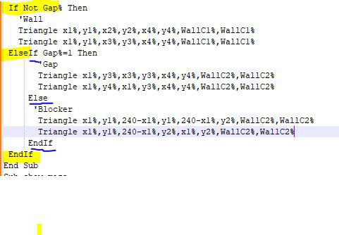

As
I used the same for the Gaps and the Wall in Front
because the parameters of the BOX command are different (X,Y,W,H).
I didn't feel like converting the coordinates again  and the
triagngle command is fast enough.

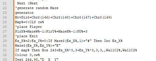

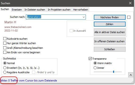

  stanleyella said  I get
RUN
[26] generatorcc
Error : Unknown command
there is no generatorcc in the Code abov.
Maybee you had some errors while Copy&Paste it or something you 've changed?
Line 23 (Not 26) calls the Sub, named generator
but no"cc" in there..
so, I have no idea what went wrong
Edited 2022-11-02 04:47 by Martin H.

  TassyJim said  For the little LCD, I find that "pink" is a better colour for the position marker. Still not easy to see.
I also added the direction arrows to the movement keys. It's more what I am used to.
Case "A",chr$(130)
 Inc PD%,-1:Inc PD%,4*(PD%=-1)
Case "D",chr$(131)
 Inc PD%:PD%=PD% And 3
Case "W",chr$(128)
I did find an extra Endif in the Draw_Element sub. Not causing a problem because it is at the end of the sub.

'no comment
Posted: 07:43am 02 Nov 2022
  Martin H. said  the first Endif  belongs to the Else if statement,
The second belongs to the enclosing IF query
It looks like the code has
ElseIf
where it should be
Else If
Or, drop an EndIf
ElseIf
where it should be
Else If
ELSE IF and ELSEIF are interchangeable in MMBasic
you would need separate lines:
ELSE
IF
for Martins extra ENDIF to be functional.
