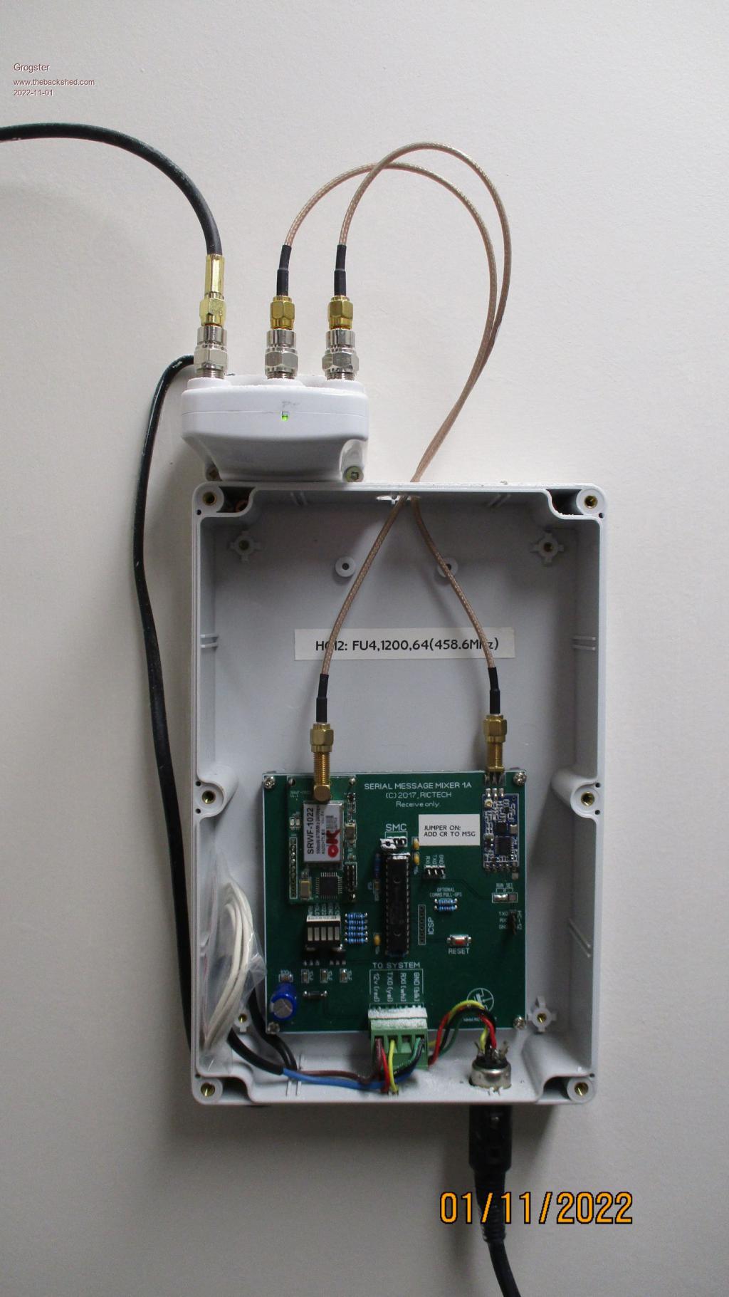

I could not find the original photos, so I took some new ones while I was out at various jobs this afternoon.
System box showing an HC12 module and a Sunray 1022 module in a mixer arrangement, using external SMA coaxes and a standard GME Kingray brand UHF booster amp.
The thick black coax comes from the roof antenna, the two thinner SMA coaxes are on the amp outputs, each one feeding its own RF module.  The Kingray TV amp is modified to remove its 230v transformer totally, and feed the amp via the 12v UPS so it keeps on working if there was a power cut.

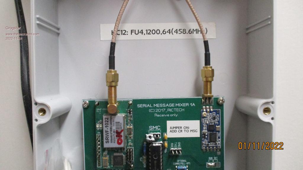

Close-up of SMA connections to mixer processor board.
A Micromite 2 does all the work.

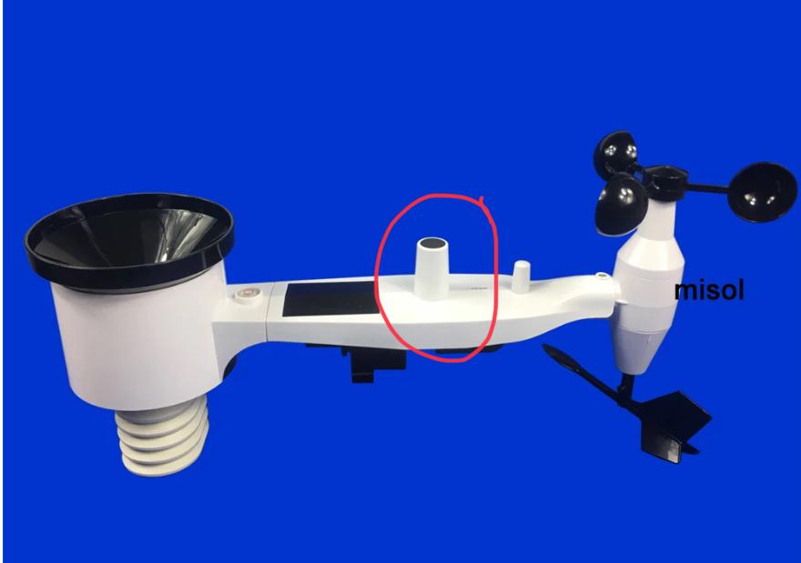

The main remote station is a commercial unit I have been busy reverse engineering it’s various sensors, it worked out the cheapest way to get all of the items as well as a suitable mounting enclosure.
See this photo, the red circled area is where the original wireless coil antenna would be located so if I can use the HC12 with the standard coil I will locate it likewise there.
I could have used the included inside display module but I wanted to use a PM and Create my own which also accesses the internet for official weather readings and forecasts using openweather plus there is no comparison between the mono LCD and bland display of the commercial unit to a PM with 3.5” TFT.
I will keep you posted on how it performs I am just awaiting a DHT22 to arrive then I will hoist it up the pole and give it some tests.
