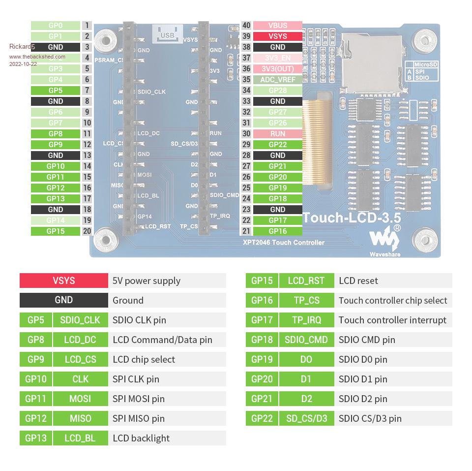

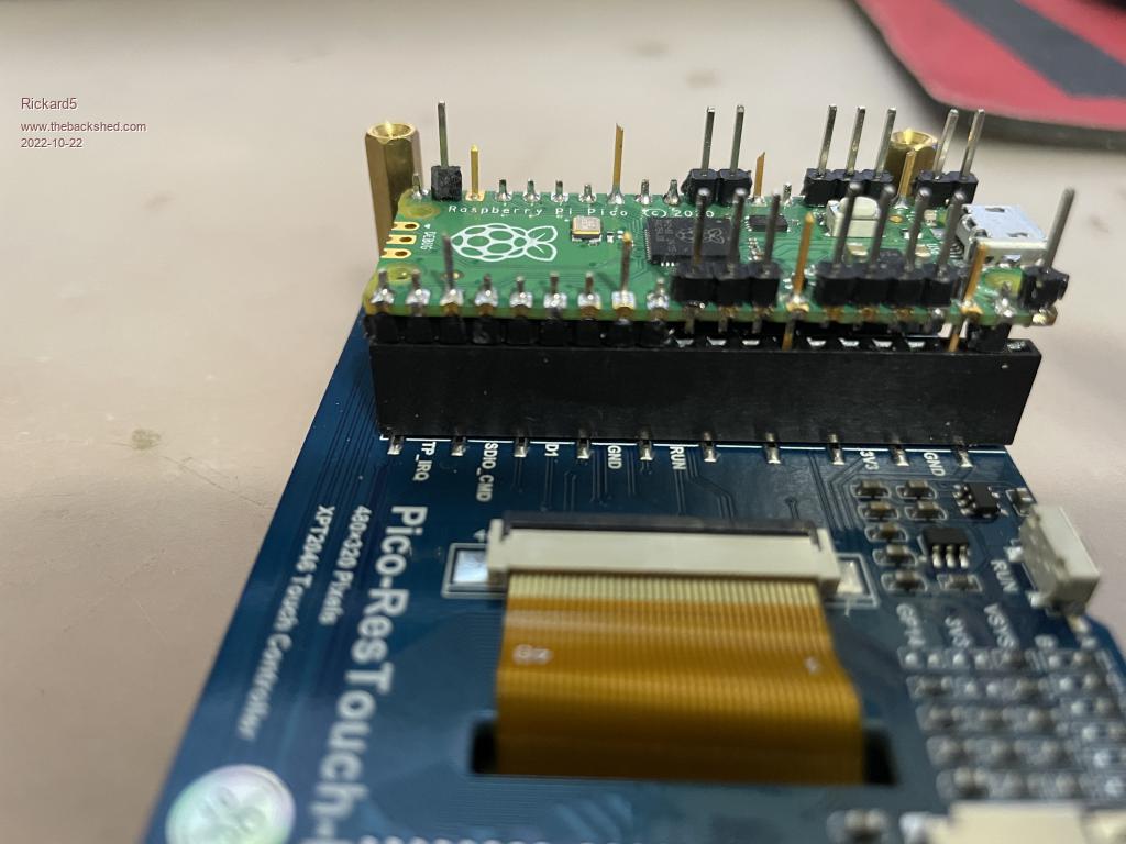

Rickard5
Joined: 31/03/2022
Posts: 463
Posted: 01:00am 22 Oct 2022
I really Love mine, for the $-Easy Ratio you just can't beat it but one thing I did when I put pins on the Pico that goes in the waveshare if you look I only put the used pins pins pointing down in to the LCD and the unused pins Pins pointing up, it's easiest to do this if you use a breadboard as a jig when soldering the pins in place

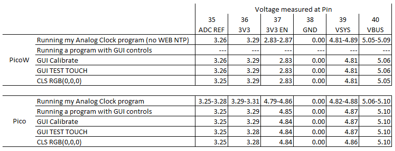

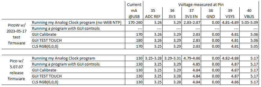

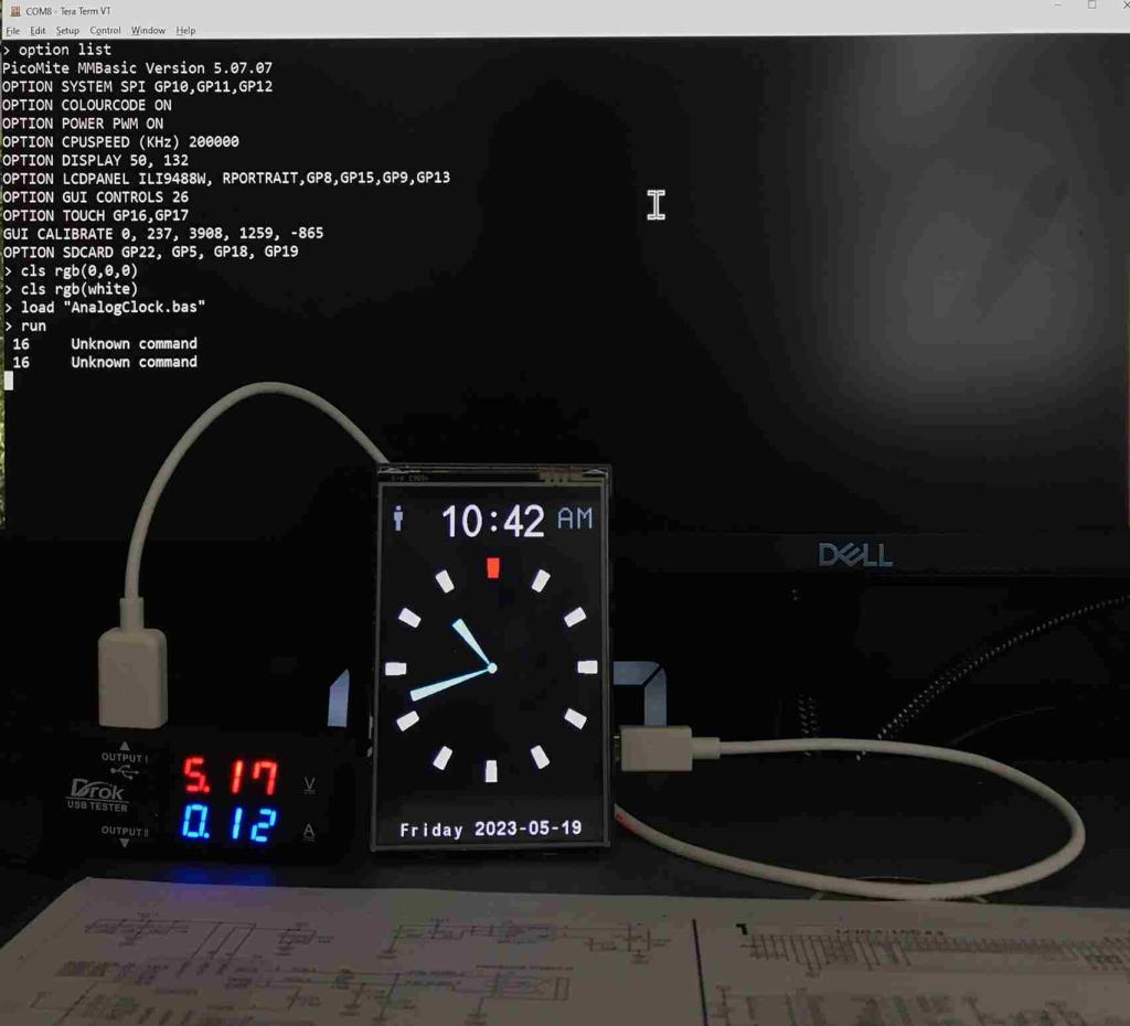

Hmmm - an interesting difference between the Pico and PicoW firmware, or my initialization for the WaveShare Pico-Eval-Board (P-E-B). Any thoughts?
I have a Pico and a PicoW, and have two of the P-E-Bs.
* The Pico will initialize, calibrate, and use the WaveShare touch capabilities just fine on both P-E-B assemblies.
* The PicoW, though it uses most of the other peripherals just fine, fails to initialize the touch circuitry correctly on both. When I run GUI TEST TOUCH, the LCD display goes white, targets are *not* displayed, and it doesn't respond to me touching the screen. I have to exit the test with a Ctrl-C, which returns control to the terminal session, but does not clear the screen. Subsequent program execution (of the clock code, above) runs normally, not requiring a restart.
Here is my OPTION LIST for the Pico (which works with the P-E-B touch, in either Portrait or Landscape mode):
OPTION COLOURCODE ON
OPTION POWER PWM ON
OPTION CPUSPEED (KHz) 200000
OPTION LCDPANEL ILI9488W, RLANDSCAPE,GP8,GP15,GP9,GP13
OPTION GUI CONTROLS 26
OPTION TOUCH GP16,GP17
GUI CALIBRATE 0, 237, 3908, 1259, -865
OPTION SDCARD GP22, GP5, GP18, GP19
Here is my OPTION LIST for the PicoW (which doesn't work in either Portrait or Landscape):
[OPTION SYSTEM SPI GP10,GP11,GP12
OPTION POWER PWM ON
OPTION AUTORUN 4
OPTION HEARTBEAT OFF
OPTION LCDPANEL ILI9488W, RPORTRAIT,GP8,GP15,GP9,GP13
OPTION DISPLAY 50, 132
OPTION WIFI MelodyGarden, ********
GUI CALIBRATE 0, 3946, 211, -1287, 853
and other info about the PicoW:
Program:
  6K ( 6%) Program (187 lines)
 74K (94%) Free
Saved Variables:
 16K (100%) Free
RAM:
  6K ( 5%) 51 Variables
  0K ( 0%) General
100K (95%) Free
I found this when trying to enhance my analog clock program, above.
Edited 2023-05-16 09:46 by NPHighview

Thank you, Peter -
Progress.
The new firmware installed painlessly (i.e. didn't erase settings or flash - nice!). I swapped TP-IRQ and TP-CS back ("OPTION TOUCH GP16,GP17"), then ran GUI CALIBRATE. This time, all four targets appeared in succession, and I got the response:
 Done. No errors
 Deviation X = 2, Y = -5 (pixels)
Running GUI TEST TOUCH, however, shows a white screen, no response to touch, but terminated without complaint when I pressed the spacebar on the keyboard.
Despite this, touch works just fine in simple code:

OK - I've had a chance to measure voltages under various conditions with Peter's 2023-05-18 03:12 interim software on the PicoW; I don't see anything obvious, except that my Analog Clock program is a heavy load.
I've ordered another PicoW to see if it behaves the same.
- Steve
NPHighview
Joined: 02/09/2020
Posts: 222
Posted: 06:04pm 19 May 2023
Peter -
Thanks for the test software iteration. I dug up my USB tester accessory, and re-compared the PicoW (with 2023-05-17 test firmware) and Pico (with 5.07.07 release firmware). Current draw is consistently higher on the PicoW (the WiFi chip, I'm sure), but still well within the 2A limit for pin 36.  I've ordered another PicoW to see how it performs. The huge current draw from earlier was caused by me toggling GP14 once every second, which left the NPN transistor drawing current through the buzzer with no current limiting resistor. I've changed that to only pulse it for a fraction of a second, enough to hear, but not enough to strain it as much as before.
