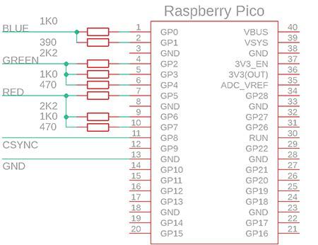

Rickard5
Joined: 31/03/2022
Posts: 463
Posted: 04:38pm 18 Oct 2022
No Mick now that you explain it, it's not going to work the Python Library is expecting this circuit
I knew I was going to spend a lot of pins on VGA and Keyboard, But I was hoping to make it with 2 picos maybe like the Pico Pair, which is giving me fits right now :( but I do have another Picomite Experimenter system in mind :)
Rick
Posts: 9260
Posted: 05:16pm 18 Oct 2022
I'm sure it would be easier with separate boards. You could layer them like hats, but have a single power supply for them all. There's no need to interconnect them and the base area is only the size of one board.
Posts: 6204
Posted: 05:02pm 19 Oct 2022
The VGA version of the picomite uses many of the pico's GPIO pins (14 of the 24 when you use all options SD/RTC/PS2/audio/VGA) leaving only 10 to play with. I will for some of my projects add I2C IO to expand the IO of the picomite VGA. Probably one or 2 PCF8574's or PCF9574's
But the free GPIO's on the VGA picomite are grouped nicely
- GP0..GP5 with digital functions, this is a nice group for PIO-1 experiments
- GP22 and GP26/27/28 (one digital and the 3 analog pins) is a second group.
So a layout looks still simple.
Moving pins around may be possible with all but the VGA pins.
The VGA pins most likely must be 6 successive pins, since the PIO is designed to work with groups of pins, not so much with individual pins.
That is why it is good you realize that the python VGA output uses 8 successive pins for RGB, and that can most likely NOT be mapped onto the picomite VGA pins, or you must redesign the PIO VGA code, and loose access to the remaining 4 pins. Are you sure the python circuit is VGA ? VGA uses HSYNC and VSYNC, not CSYNC. anyway..
Also interesting to note that some pico VGA systems use a I2S audio DAC (not the 44kHz PWM the picomite uses). So making a universal platform will require you to duplicate all these specific hardware differences. Challenging...
Although picomite platform has it's specific limitations, it is astonishing so much can be done with a cheap chip. We have to thank Peter and Geoff for that.
