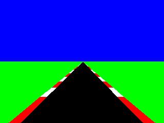

Proof of concept..
parts of the concept are inspired by olc https://youtu.be/KkMZI5Jbf18
Dim Col%(15),Xofs%(160)
Restore colors:For f%=1 To 15:Read Col%(f%):Next f%
SH%=240:SW%=320
dist%=0:Speed%=15
Option Break 4: On Key 3, on_break
MODE 2
FRAMEBUFFER create
FRAMEBUFFER WRITE F
For f%=0 To 159:Xofs%(f%)=((160*Exp(f%/50))/20)-8:Next
CLS COL%(1)
HW%=SW%/2:HH%=SH%/2:t%=Timer

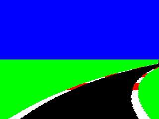

 'bend right
 For n%=1 To 1000 Step Speed%
   Box 0,hh%,SW%,hh%,,COL%(2),COL%(2)
   For F%=0 To HH%
     bc%=get_BorderCol%()
     ofs%=xofs%(hh%-f%)*n%/400
     BB%=Int(f%/5)
     Box HW%-F%-bb%+ofs%,HH%+F%,bb%+bb%+f%+f%,1,,bc%,bc%
     Box HW%-F%+ofs%,HH%+F%,f%+f%,1,,0,0
   Next
   FRAMEBUFFER COPY F,N,b
   Inc dist%
 Next

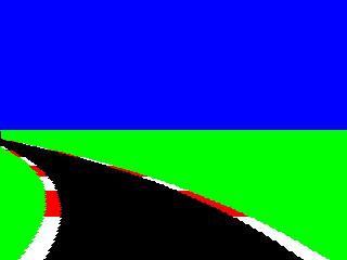

'bend left
   For F%=0 To HH%
     BB%=Int(f%/5)
     Box HW%-F%-bb%-ofs%,HH%+F%,bb%+bb%+f%+f%,1,,bc%,bc%
     Box HW%-F%-ofs%,HH%+F%,f%+f%,1,,0,0
   Next
   Inc dist%
 Next

feel free to use and improve it,
if someone likes to write a Racing game for the Pico
if you want to drive straight ahead just do a loop with ofs%=0

Every single Frame is completly redrawn.
With the use of the Framebuffer I can redraws the screen hidden and make it Vissible when it is ready. This makes the screen animation flicker-free.
Here I paint the Lower half of the screen, green, then I draw Line by Line, the Border and the Street.
by giving up the get_BorderCol% Function call and replacing with
bc%=col%(7-3*((Sin((((150-f%)/40)^3)+dist%))>0))
this little demo gets up to 30 fps

with CPUSPEED 378000 i get a result of 22-23 fps. To speed things up, one can half the Resolution of the street (as originally using the Box Command with the height of 2 and just draw every 2nd Line)
please try it and give me a Feedback
