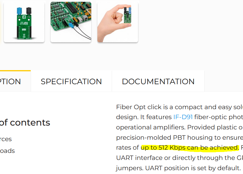

Can anyone see why this Click module is limited to 512Kbs?
Seems really slow to me.

Hi Craig,
Where did you see 512kbs?
The chip itself is quoted at 5MHz which if you assume 10bit per byte (8bit data plus 1 start and 1 stop bit) that would men 512kB (ie k BYTEs) per sec.

@bigmik
Hi Mick,
Right on the main page....could've sworn that I saw another spec' that claimed a much higher speed but maybe it was my imagination...dunno.
