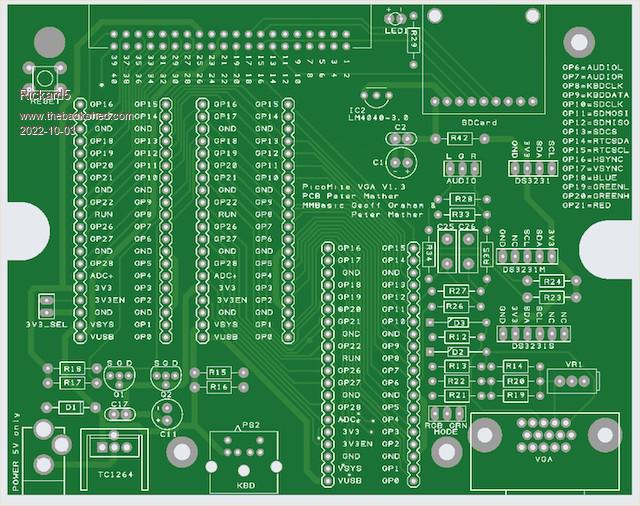

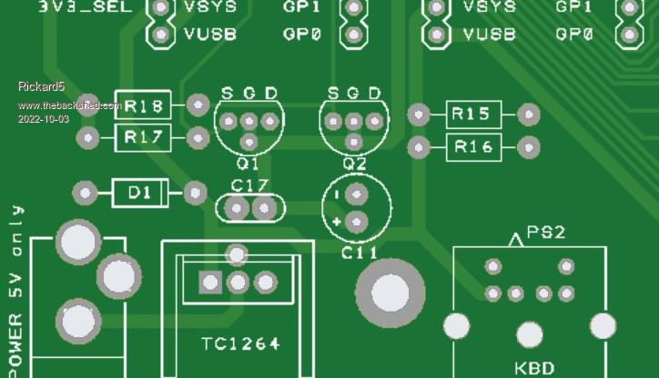

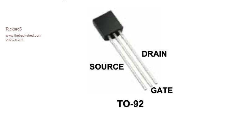

Hi everybody, I'm building a new Picomite VGA Design #2, I'm thinking it'll be cool to take with me camping :) any how I have both the BST72A and  TN0702N3-G transistors specified as Q1 & Q2 in the BOM for the KB interface, the problem I have is the transistors all have 3 legs and the board's have 4 Holes for each, the Question is with 3 holes do I use. Do I use the upper or lower center hole ?

It may have been designed to take either the in-line format or the tripod format. On the back of the board, are the middle and offset holes connected?
In any case, the offset hole is definitely connected to ground, so if you use that and have S and D right, then you should be good.
Posts: 3418
Posted: 10:52pm 02 Oct 2022
"the offset hole is definitely connected to ground,"
Vcc perhaps? The circuit shows that.
Posted: 12:35am 03 Oct 2022
  phil99 said  "the offset hole is definitely connected to ground,"
Oh, you are right--3V3. I assumed too much from the SGD silk screen.

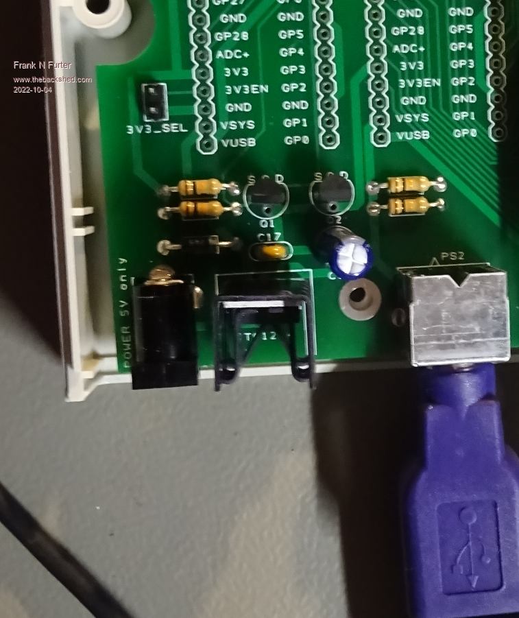

Posted: 05:23pm 03 Oct 2022
Hi RickardS,
I have used TN0702N3-G:
Frank

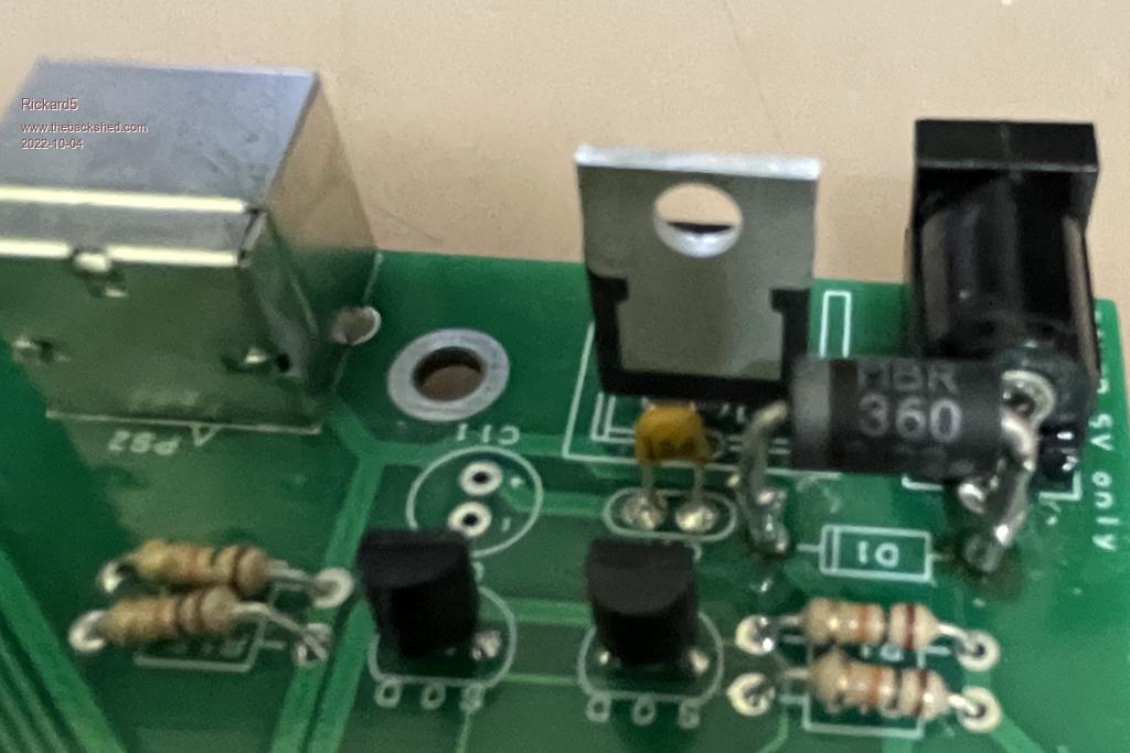

Rickard5
Joined: 31/03/2022
Posts: 463
Posted: 07:56pm 03 Oct 2022
  Frank N. Furter said  Hi RickardS,
Frank
Hey Frank I ended up using the TN0702N3-G too. can I ask what you used for D1 MBR360G?, I ordered the MBR360G from 3 different vendors and always got a Diode with leads too thick too fit though PCB. So my solution was to rob some Machined pins fro
m a socket and solder them in then solder Diode to the Pins!
