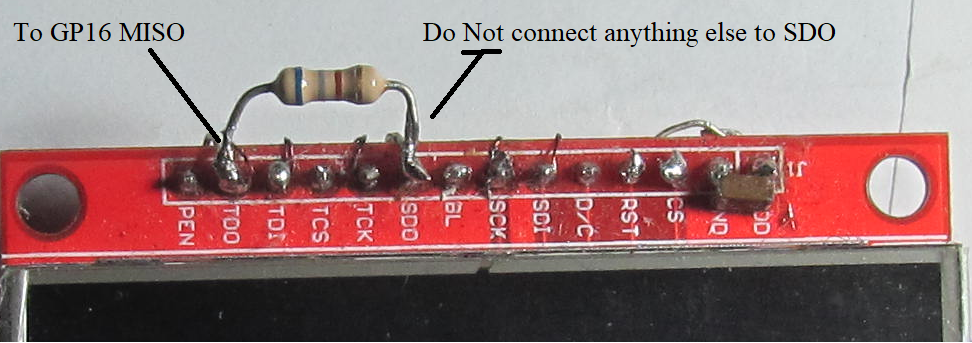

Reading about the ILI9488 MISO fault in which the MISO doesn't go into tristate and thus the SPI can't be shared unless the LCD MISO is disconnected, I wonder if a buffer could be placed between the MISO and connection controlled by the LCD CS line.
It seems to me to be a solution to getting an ILI9488 operating correctly and fully functional while sharing the SPI bus with other devices (sd card) but I could be over looking something.
Anybody ever try this?
Something like this  ?

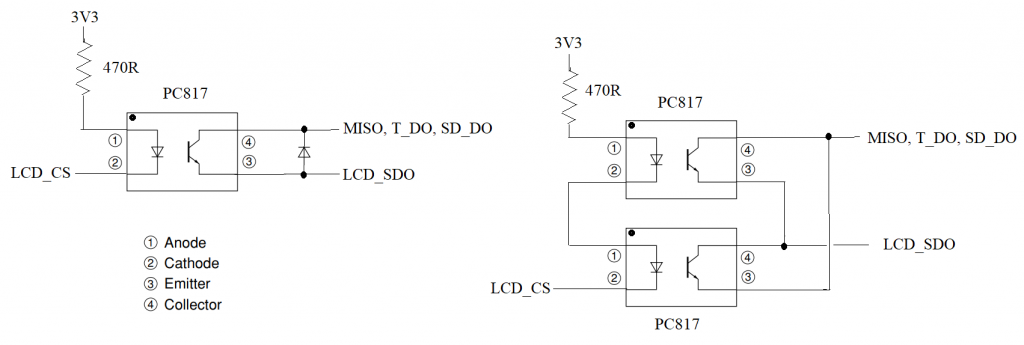

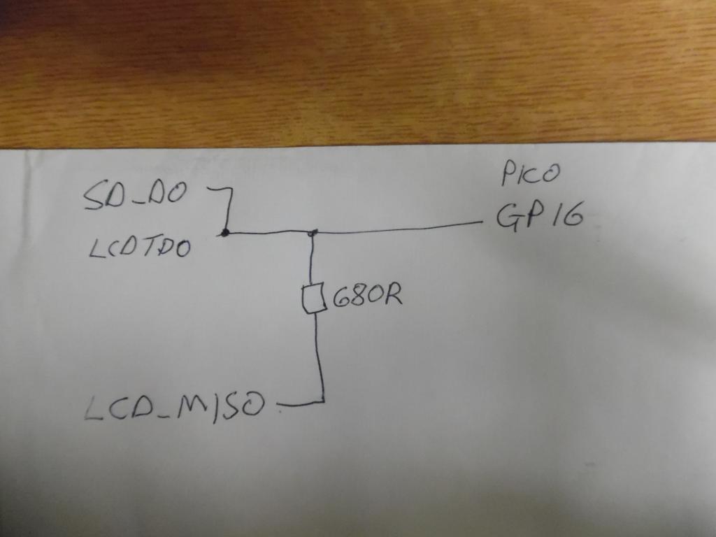

680 ohm resistor in the ILI9488 MISO line normally works. Else it can be done with a single transistor. Someone posted the transistor circuit recently and hopefully they will chime in
Posts: 3418
Posted: 11:12pm 25 Sep 2022
Here it is.
https://www.thebackshed.com/forum/ViewTopic.php?TID=11419&P=3#191429
The transistor only connects LCD_SDO to MISO when LCD_CS is pulled low.
Most people find just the resistor is enough but I found SD card access unreliable.

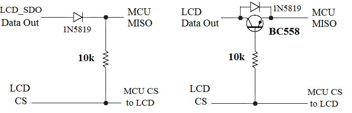

Edit 27/10
Tested a pair of diodes and and SD card, Blit, Save Image and Pixel() all work properly.
Have tested with resistor values from 1k8 to 10k.
A pullup from MCU MISO to 3V3 could be added if needed. 5 to 10 times the CS resistor value.

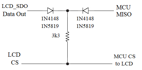

Decided to see if the BC557 could be made it work reliably. The closest I have is a BC558 and it too needed a very low value base resistor. As the chip problem is that SDO is active low when it should be off a diode with anode to SDO was added as per the diagram. Tested with Pixel (above colour counters return 64 each for R, G & B), Blit, Files, Load Image and Save Image.
Using the "Remove Bits Till it Fails" design philosophy the Diode Switch passed all the above tests with just one diode.
PS Touch also works.
Edited 2022-11-21 22:10 by phil99
Footnote added 2024-04-15 12:11 by phil99
The 4" IPS ILI9488 is different to the panel above. The resistors near the SD socket are 4.7k pull-ups. R8 on SDO must be removed if the SD card is sharing SPI with the LCD panel. Otherwise the 10k (can be 4.7k to 10k) is unable to pass SDO to MISO.
You can use other diodes provided they have sufficient junction capacitance.
eg 1N400x series rectifiers work but 1N914 and 1N4148 don't unless you add 22pF to 150pF in parallel.

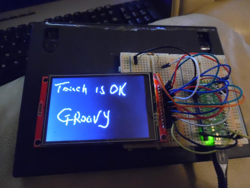

Posted: 07:46pm 24 Nov 2022
the ili 9341 amd ili 9488 have the same pins.
ili9341 all works.
ili9488 graphics works but connecting touch and calibrate did get to 2 checks but failed, now it fails after first test. yawn.
I will stick to ili9341 which works.... and 320x240 is more normal.
pity, 9488 does graphics ok

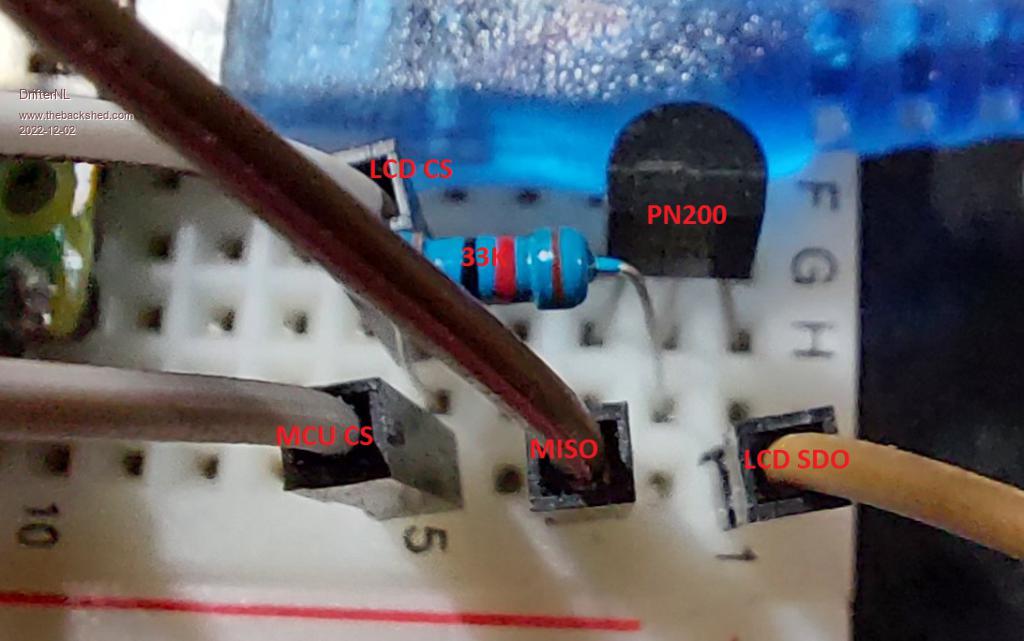

My PN200 transistors came in and I tried the circuit.
It was still not working until I changed around the emitter and collector and all seems to work now.
The SD card, touch and Blit works as well as pixel.
Maybe I got stand-in / fake PN200s?

Posted: 11:03pm 27 Nov 2022
I tried the circuit https://www.thebackshed.com/forum/uploads/phil99/2022-11-21_155644_ILI9488%20MISO%20Fault%20Fixer-2.png
But got to try in5819,so order, schottky, low voltage drop.
best I get with a in4001 was all four test points working but bad calibration problem.
from there it is two tests work then calibration error.
display works fine.
Posts: 3418
Posted: 12:01am 28 Nov 2022
Tested it with 1n4007, 1n914, 1n4148 and resistors from 3k3 to 10k.
All work with this test program.
https://www.thebackshed.com/forum/ViewTopic.php?FID=16&TID=11419&LastEntry=Y#194465#194465
Perhaps the touch chip was damaged if you connected it without a resistor or diode in series with LCD_SDO. When idle it is active low so when the touch T_DO goes high it is driving in to a very low resistance (about 40 ohms).
To test this remove the diode and resistor and leave LCD_SDO unconnected. Then try to calibrate touch. If touch won't work with nothing else sharing MISO it may be damaged.

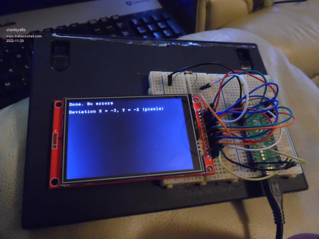

Posted: 04:32pm 28 Nov 2022
  phil99 said  Tested it with 1n4007, 1n914, 1n4148 and resistors from 3k3 to 10k.
removed the diode and 10k and disconnected lcd miso then touch do and it did the gui calibrate and test??? weird. it is not to supposed to work.

Posted: 07:12pm 28 Nov 2022

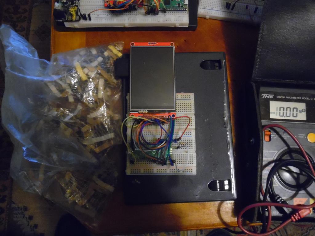

Hi phill99. I appreciate your replies.
The ili9488 seems ok when it should have problems. odd
Tried a blit program and it now fails. Does not blit. Is this relevant? I knew too good to be true.

Posts: 3418
Posted: 09:46pm 28 Nov 2022
Ok that proves the touch chip has not been damaged, it was just interference from LCD_SDO preventing touch working. Blit, Pixel() and Save Image cannot work while LCD_SDO is disconnected. That is the pin that sends data from the screen to the Pico.
The problem is three outputs (LCD_SDO, T_DO & SD_DO) must share one input (MISO). For that to work only one can be active at a time, and the faulty LCD_SDO is always active.
The reason for the 680R or transistor or diode circuits is to provide enough isolation from LCD_SDO to allow touch and SD to work but still allow LCD_SDO to access MISO.
Perhaps the fault on your panel is different. Measure the voltage between LCD_SDO and Gnd. (with nothing else connected to that pin) and let me know what it is. Mine is close to 0V.
How the diode switching is supposed to work:-
With LCD_SDO low and LCD_CS high the diode is reverse biased, isolating LCD_SDO from MISO so touch or SD should be able to send data to MISO.
When the Pico wants data from the screen the Pico pulls LCD_CS low (the other two CS pins are high keeping Touch and SD off). This allows the diode to be forward biased so LCD_SDO can send data to MISO.
When screen data sends LCD_SDO high (and LCD_CS is low) it goes through the diode to MISO.
When screen data sends LCD_SDO low (and LCD_CS is low) the resistor pulls MISO low.
Edited 2022-11-29 17:33 by phil99

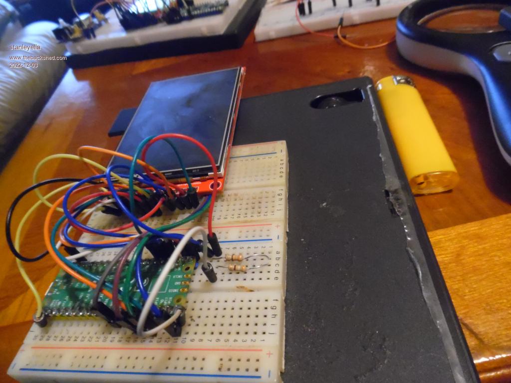

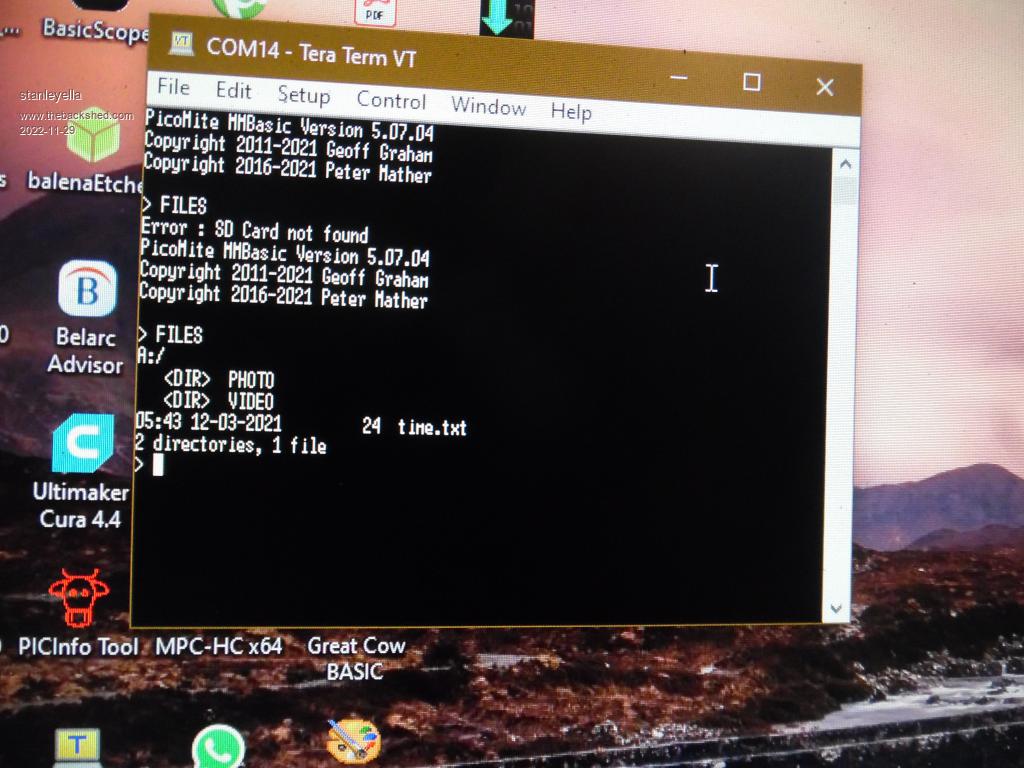

Posted: 10:27pm 29 Nov 2022
  phil99 said  Ok that proves the touch chip has not been damaged, it was just interference from LCD_SDO preventing touch working. Blit, Pixel() and Save Image cannot work while LCD_SDO is disconnected. That is the pin that sends data from the screen to the Pico.
great info but same problems but only tried 680R and the diode/10KR
It is either graphics including blit but no touch
or working touch, sd card and graphics but no blit... which I had never thought would be affected.
If I can not get it to work like ili9341 then do I need blit? would gui dials be affected?
I can not get it to do blit even after option reset and resetting everything, what an interesting display. Not boring like ili9341 which works.
Edited 2022-11-30 09:32 by stanleyella
Posts: 3418
Posted: 01:42am 30 Nov 2022
Blit, Pixel() and Save Image all need to read data from the screen and thus need SDO (Serial Data Out).
The 680R only provide partial isolation but everyone else has found it good enough to get touch working as the touch chip can easily supply the 4.5mA that the 680R draws.
SD cards can be a bit fussier, so some form of switch is needed to turn SDO off when the SD card is in use.
Are you certain all the breadboard connections are perfect? No one else is having this much trouble.
Try the transistor one here.
https://www.thebackshed.com/forum/ViewTopic.php?FID=16&TID=15214&LastEntry=Y#194594#194371
I will experiment with other methods.
Edit
Other Methods. Both of these pass all tests. Just about all normal optocouplers should be ok.
Otherwise I can come over and have a look at it. Just send the airfare, business class will be adequate.
