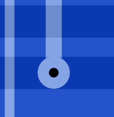

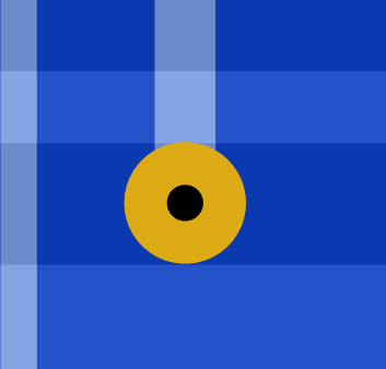

F12 will change any highlighted footprint from single-layer, to two-sided with plated through holes.
So, click a part, and press F12.
The pads will change from green or blue, to light blue, which means it is a plated-through pad on both sides.(when using the standard colour scheme)  Basically, you are turning the pads into vias, but just all pads in one keypress for any pre-defined component you have placed.
Repeat to turn the pads back to single-layer if needed.
If you have enabled ground-planes on your top and bottom copper layers, F12 will space the pads off the ground-plane on both sides.

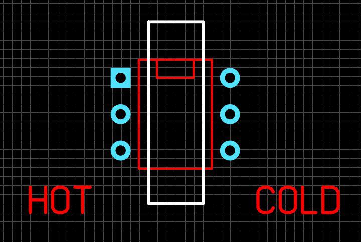

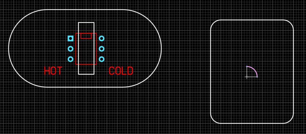

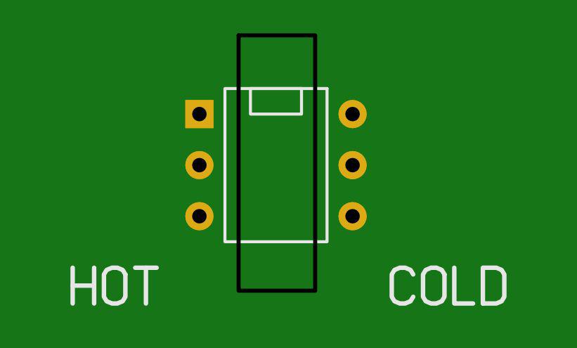

Further to what Mick said, making LARGE holes or cutouts in your board, is done by drawing the shape on layer zero.  If you wanted a 30mm hole in your board for a huge arcade-style button for example, you draw a circle with the circle tool, on layer zero.
EDIT: VERY quick example of a 6-pin DIL opto-isolator with a slot cut underneath it.  This is a 0.635mm grid, so the slot is 3.8mm wide.
Note the light-blue pads on the opto, meaning this part has plate-through holes, with pads on both top and bottom of the PCB.

  Mixtel90 said  You can't have true curved PCBs though AFAIK.
You can, but it requires much more work then standard square or rectangular.
To make a curvy board, I start with the CIRCLE tool, and draw a circle of suitable size.
Click the circle, drag the node to turn the circle into an arc.
Right-click/Duplicate as needed.
Flip H and V and rotate as needed.
Place till you have the final outline.
Use the track tool to draw lines between the nodes on the arcs.

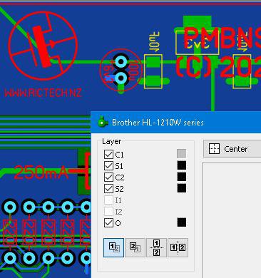

Layer zero is not printed, as normally you don't need it to show up in printouts, as it is a machining layer, not really a layer for showing on printouts.
To make it show up when you do prints of your layout, make sure that there is a tick in the "O" checkbox in the print preview window.
Click the printer icon on the top taskbar on SL6, then refer to the checkboxes at top-left of the window:
