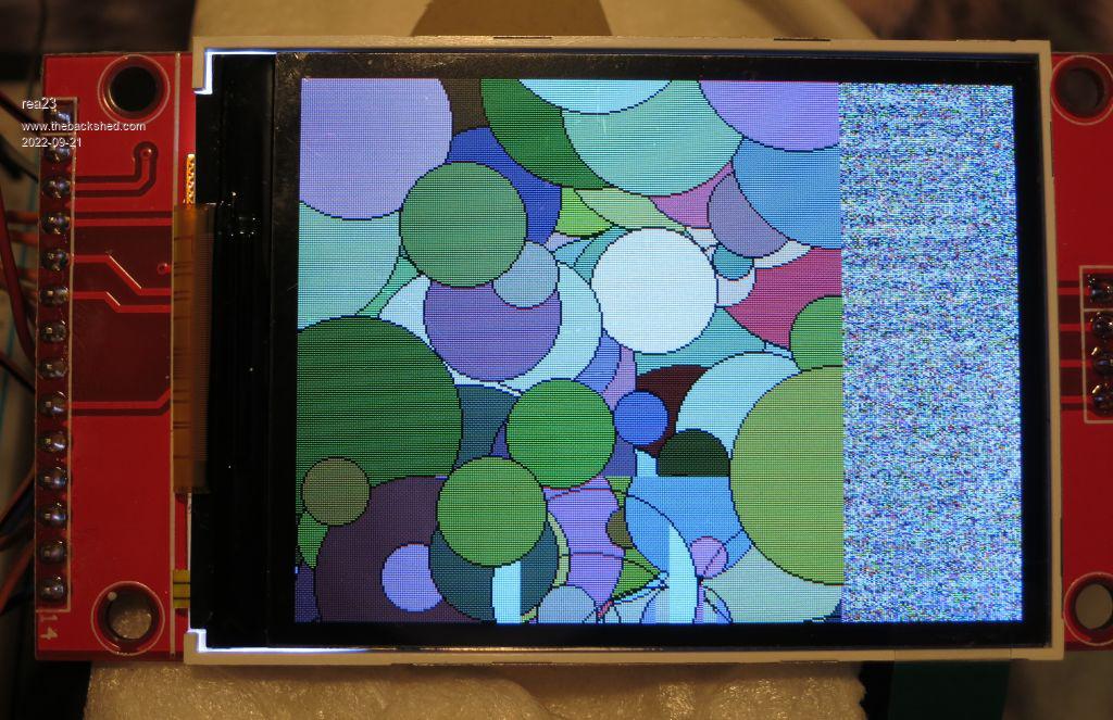

Hi, I am new here. Found MMBasic and it is great!
My first attempt is always a program that tests the raction time to a visual (LED) or audible (buzzer) signal.
First I used a 3.5 inch display from waveshare (ILI9488W) with touch and sdcard reader. Everything works very well on the 480x320 pixel display, including touch and sd-card.

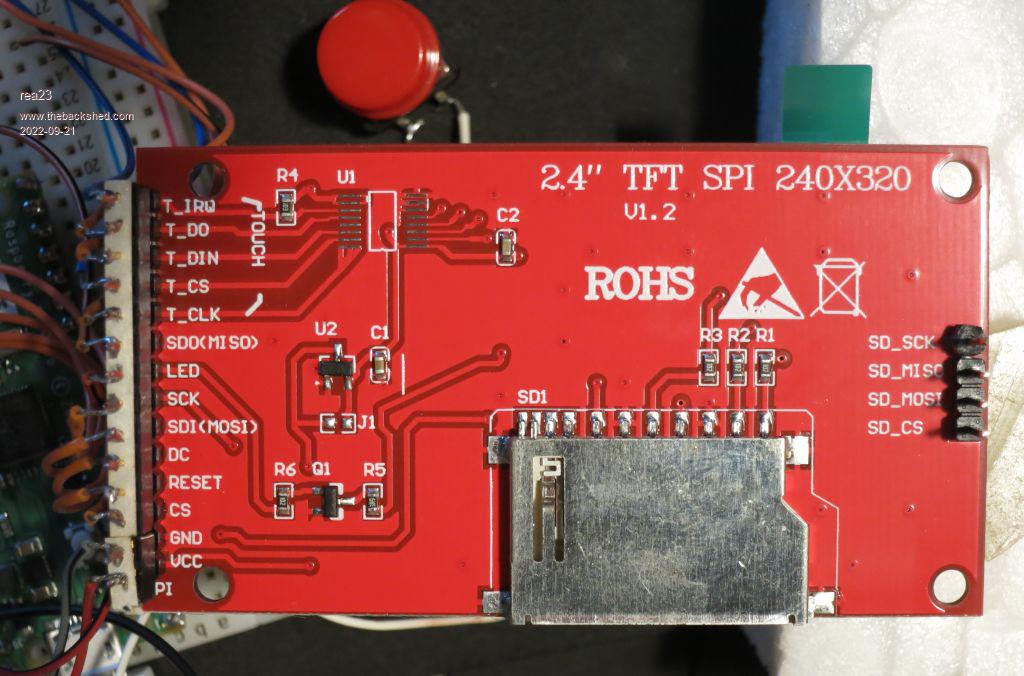

Now i am trying the same on a display with an ILI9341 controller. It is the display shown on page 47 in the manual. The connections to the pi pico are the same as in the manual. Connections for touch and sd-card are not made at the beginning.
Option settings are:
OPTION SYSTEM SPI GP18, GP19, GP16
OPTION LCDPANEL ILI9341, L, GP15, GP14, GP13
The problem:
With "GUI TEST LCDPANEL" the test is runnig, but the display shows only a resolution of 240x240 instead of 320x240. However, the command "PRINT MM.HRES" correctly displays 320. I have checked all connections several times and also used other GPIO's, but it remains the same. I am almost sure that the display is ok, because when changing the orientation, the other side of the display is ignored respectively the old content in 120x240 remains in place. I also deleted the firmware (V.5.04.07) and installed it fresh on the pico. But that has also not changed anything.
If anyone has an idea, I would appreciate any help. Thanks in advance.

  rea23 said  Connections for touch and sd-card are not made at the beginning.
Your module has no touch controller (not soldered on the board).
I have no idea about the part of the display that is not working. Sorry. Maybe it is wiring (16MHz SPI clock ?), maybe it is the LCD supply voltage.

Sorry for my typo. Of course I'm using 5.07.04. OPTION TOUCH is disabled. As recommended, I wired the CS line to ground. After that the whole display 320x240 is white illuminated. GUI TEST DISPLAYPANEL shows nothing. IF CS is connected back to GP13 the test works as before with 240x240 pixel. Therefore I'm ready to use the display with this resolution. And i will not buy such a display from the same seller again.

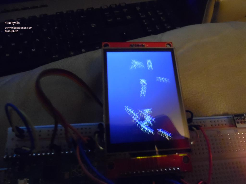

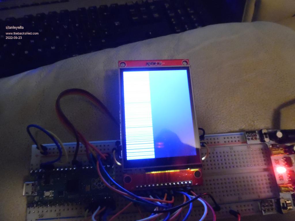

My experience on one ili9341. I recommend you do not assume a device works.
First image is it running from 5V as it should but there is a display problem.
image2 is it running at 3.3V ,I just swapped the lcd supply to 3.3V
Edited 2022-09-23 04:42 by stanleyella

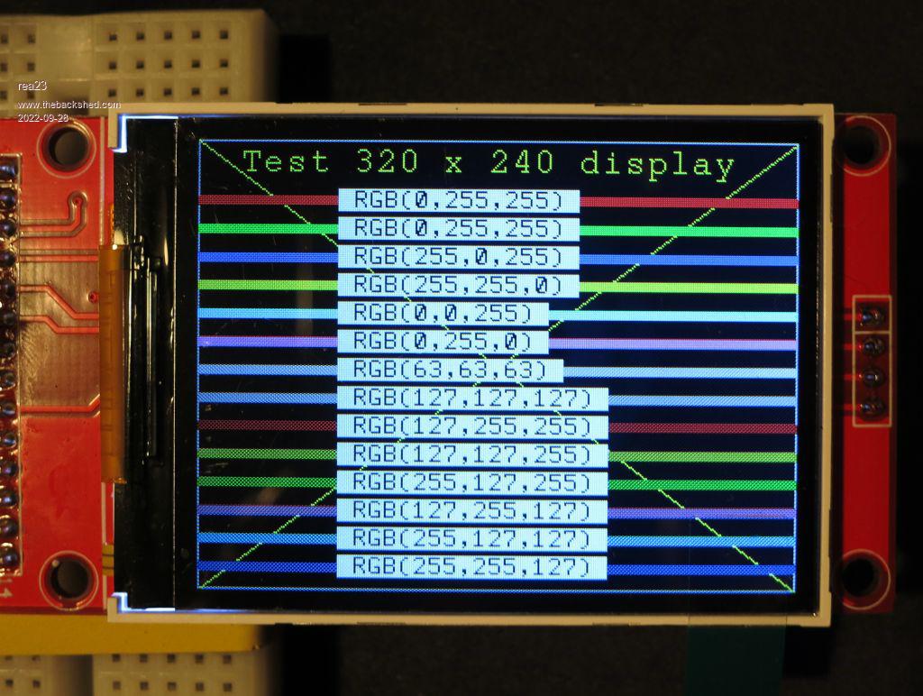

Hi, I have tested all the suggestions. In the end the hint with the other display driver was successful. When using the ILI9488 driver in portrait mode, the display shows all pixels in the range of 0-320 (not only 0-319) and 0-240. The display is currently running at 3.3 volts.
OPTION LCDPANEL 9488, PORTRAIT, GP15, GP14, GP13   (why portrait?)
The colors are inverted, i.e. you have to enter the inverse RGB values to display the desired color. This is a bit strange and I don't see the reason for it. But otherwise everything is fine so far.
Thanks again for the help, Hausi

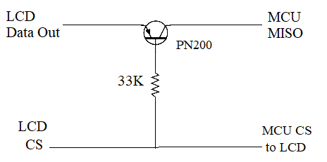

That is a good way to determine if it is an ILI9488 chip. If an SD card will only work with shared SPI when there is a 680R or switching transistor in between LCD SDO(MISO) and Pico MISO.
