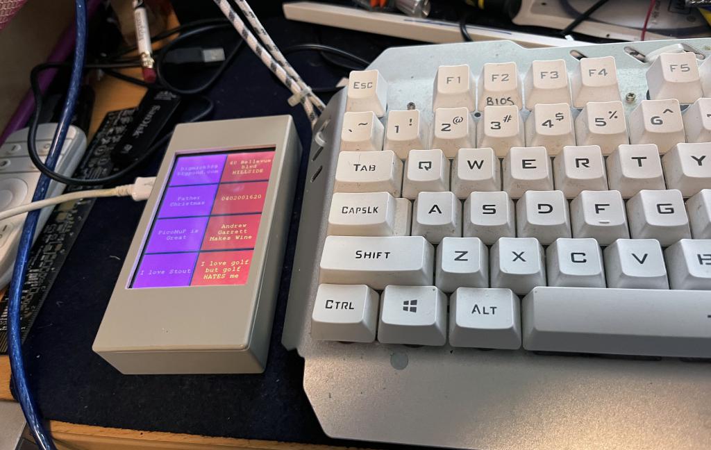

Now this sets up on a 480 x 320 display (the picture below shows an ILI9481 but an ILI9488 can also be used) as an extra/programmable keypad that sits nicely next to my keyboard.
I simply tap the key I want and it sends a string to a serial port.
Currently I am using the Console serial port but It ultimately will also work using the serial port (and a USB-TTL adapter) to feed strings into a USB (set as a COM port on the PC). This is not currently tested.

As Datasnip (the paid version) has 2 programmable keys that can send a string out of the COM port I am currently working on adding a second page of buttons that can be toggled by a `hot' key.
Alright, I hear you saying there are many keyboard wedge programs out there BUT this has the advantage of showing what the key you press is without having to remember what hot key to use and what that hotkey is associated with.

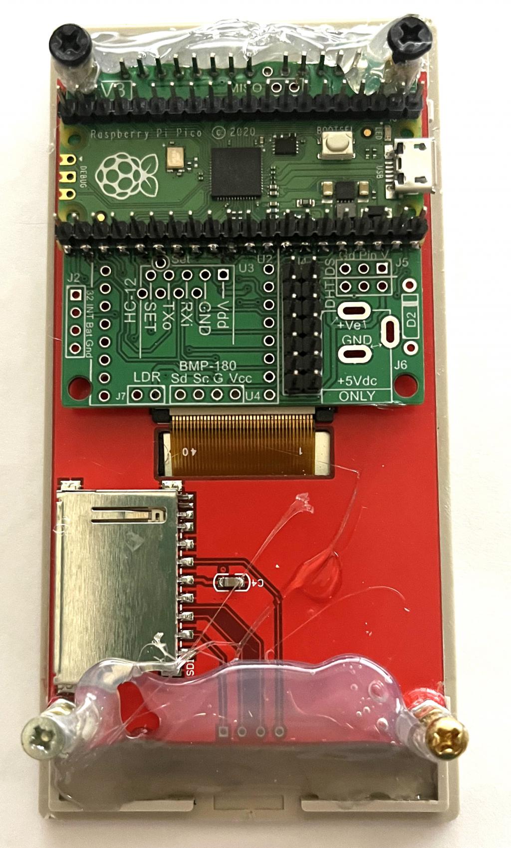

Here is a Picture of the Inside showing one of my PicoMuPs on the display.
The 4 screws are adjusted to hit the bottom of the case and absorb any heavy handed pressing of the touch screen the `hot snot' is simply to stop the screen moving vertically and horizontally.
Mik

Mick's photo above - ie the back of the LCD with the 'Hot Snot' - also shows Mick's PicoMup.
I'm not sure that he has 'released' it yet but one of these will form the basis of my Weather Station upgrade. It houses WiFi, DS18B20, HC-12, BM180, RTC and can connect to VGA or LCD, and breaks out all of the Pico's available data pins - plus more. All in a very small footprint.
