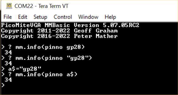

Hello Peter,
A few more bugs for the pot:
1. MM.INFO(PINNO ...) is now broken - worked prior to RC2:
PicoMiteVGA MMBasic Version 5.07.05RC2
Copyright 2011-2022 Geoff Graham
Copyright 2016-2022 Peter Mather
> list "mminfo_error.bas"
Option Default None
Option Explicit On
Print MM.Info(PinNo GP28)
> run "mminfo_error.bas"
[3] Print MM.Info(PinNo GP28)
Error : GP28 is not declared

Posted: 04:56pm 24 Sep 2022
V5.07.05RC3
Improved error messaging for incorrect pin usage.
Fixed MM.INFO(pinno when OPTION EXPLICIT specified.
Geoff asked for the keyboard default as both the antipodeans and US use it
Edited 2022-09-25 03:04 by matherp

  matherp said  V5.07.05RC3
Thankyou Peter, that works. I didn't know that about our Antipodean cousins and their keyboards

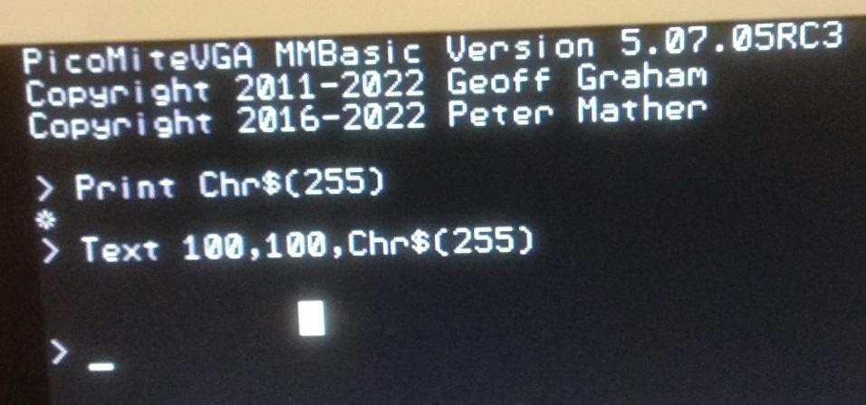

Could you take a look at this issue using TEXT and CHR$(255) for me please:
Also an observation that I'm not sure what to make of, but might lead you to identifying a bug, try this on the CMM2, PicoMiteVGA (use Mode 2, not Mode 7) and MMB4W:
Mode 7:For i=1 To 10:Text i*Mm.Info(FontWidth),"A","CT",1,1:Next
- For the CMM2 and PicoMiteVGA the characters start at the 2nd horizontal pixel position and each overlaps the previous by 1-pixel.
- For MMB4W the characters start at the 3rd/4th horizontal pixel position and do not overlap.
Edited 2022-09-25 22:42 by thwill
Posted: 12:58pm 25 Sep 2022
This is the code for the text issue - something Geoff has put in the MM+ and I've just copied
   while(*str) {
       if(*str == 0xff) {
//            fc = rgb(0, 0, 255);                                // this is specially for GUI FORMATBOX
           str++;
           GUIPrintChar(fnt, bc, fc, *str++, jo);
       } else
           GUIPrintChar(fnt, fc, bc, *str++, jo);
This is missing the Y coordinate
Edited 2022-09-25 23:01 by matherp

  matherp said  This is the code for the text issue - something Geoff has put in the MM+ and I've just copied
   while(*str) {
       if(*str == 0xff) {
           str++;
       } else
Right, so there is a "hack" for character 255 in the 'mite code which is why it doesn't behave - I don't suppose @Geoff will notice and comment. Looking at the MMB4W code that hack does not exist there (Draw.cpp#748-749) which is why it worked when I originally developed the code in question (on MMB4W).
Transcription error, what I meant was:
Mode 7:For i=1 To 10:Text i*Mm.Info(FontWidth),100,"A","CT",1,1:Next

I've emailed Geoff to ask about the other issue. There is a hole in the code as-is because if 255 is the last char then the code can loop past the end of the string
