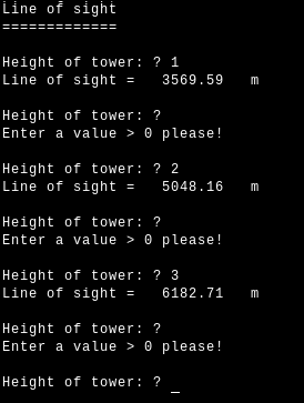

It's strange in a different way with the Windows version (no INKEY$ loop) as well:
Edited 2022-09-19 04:47 by toml_12953

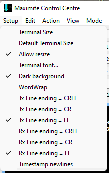

In MMCC, set the Tx line-ending to 'LF' rather than CRLF.
I find that for the picomites, setting Tx and Rx both to LF is the best option.
You would need to do the same with TeraTerm.

Hello Jim,
I tried that LF for both Send and Receive but it didn't change the behaviour. Same with CR for both.

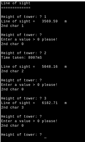

Then I inserted a PRINT statement which prints the 'towerhight' INPUT value and I found that the second value is "0"
changed program:
' lineofsight.bas
' calculate how far you can see on a tower of hight towerhight
' (2022) Andreas Mueller, Gerolsbach
const radiusearth = 6371000 ' meters
dim towerhight as float = 0.0
cls
print "Line of sight"
print "============="
do
 print
 input "Height of tower: "; towerhight
 if towerhight <= 0.0 then
   print "Enter a value > 0 please!"
 else
   print "Line of sight = ", int(100*sqr((2 * radiusearth * towerhight) + towerhight^2))/100," m"
 end if
 print "2nd char"; towerhight
 'do while inkey$ = ""
 'loop
loop
-andreas

In my tests on Linux, the menu changes to the line ending settings take effect immediately. There should be no need for any restart.

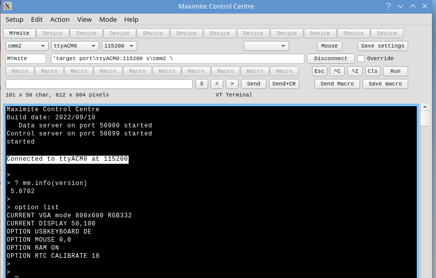

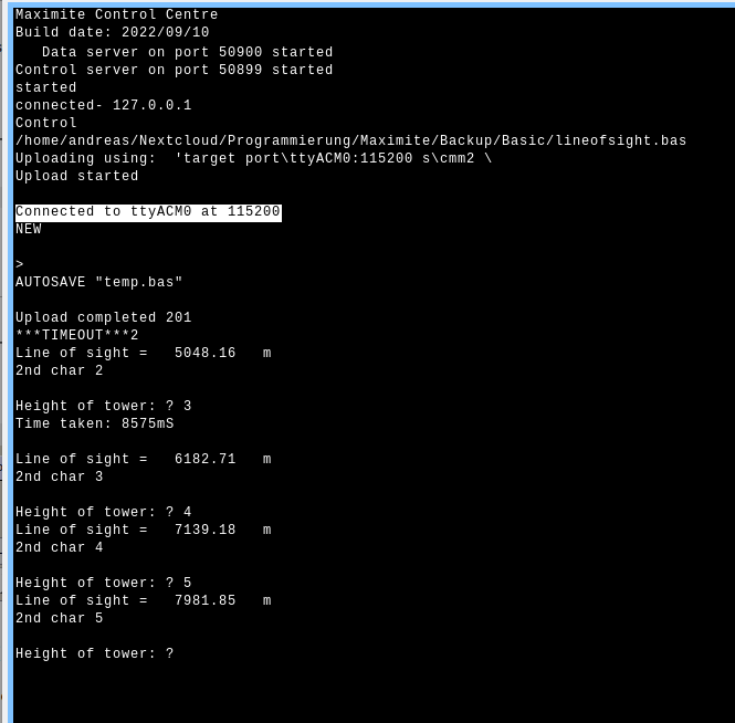

Looking at your screenprint, I assume that you loaded the bas file by dragging and dropping onto the desktop shortcut. That is the only reason I can give for the connection to the control port.
Not a problem, just interested in how the program gets used.
The date of your MMCC is 10th Sept. There is a 15th Sept version posted which fixes Linux printing.
You also didn't have the connection to your picomite configured, MMCC thinks it is a CMM2, the old default. That might explain the Timeout. If you setup a connection for the picomite and preferably save it as a device setting, MMCC will use the last setup each time and life will be easier for you.
No, I'm clicking the "Load file and run it" button within MMEdit
  TassyJim said  Not a problem, just interested in how the program gets used.
Oh, I will download the latest version and test it!
  TassyJim said  You also didn't have the connection to your picomite configured, MMCC thinks it is a CMM2, the old default. That might explain the Timeout. If you setup a connection for the picomite and preferably save it as a device setting, MMCC will use the last setup each time and life will be easier for you.

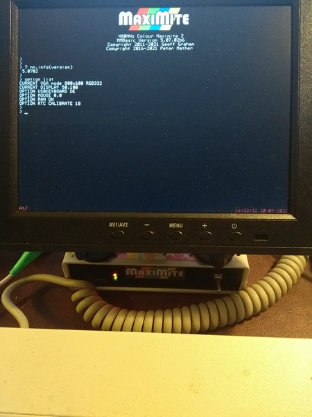

I'm using MMEdit with my CMM2 (!) - the USB power connector is connected to my main PC running Linux (Mint Version 21 "Vanessa") So the Colour Maximite 2 gets its power and control by the USB cable.
I have setup CMM2 with ttyACM0 115200 within MMCC as MySite
-andreas

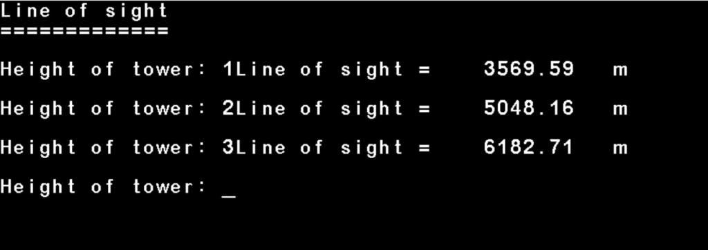

A picture says more than 1000 words ;-)
-andreas

Sorry I missed the fact that you are running your CMM2 - my mistake.
I run my CMM2 at 460800 baud reliably. It makes file transfers much easier to take.
Last time I tried, the CH340 USB-TTL didn't work with my VM so I can't test it from Linux.
