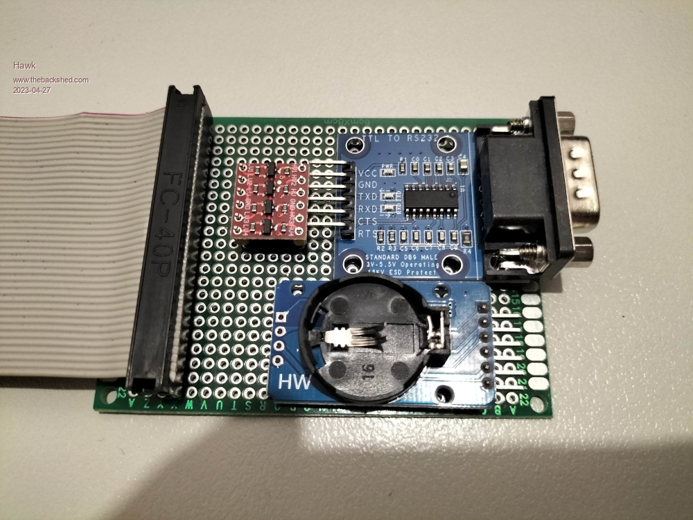

Here's the prototype layout for my RS232 interface.  I've added a RTC module as well.
Pin Allocations:
DS3232 RTC
SCL - GP27 (Pin 32 of Pico module)
SDA - GP26 (Pin 31 of Pico Module)
RS232 Module
TXD - GP0  (Pin 1 of Pico module)
RXD - GP1  (Pin 2 of Pico Module)
CTS - GP2  (Pin 4 of Pico module)
RTS - GP3  (Pin 5 of Pico module)
And all the pins on the 40 pin header correspomd to the pins on the Pico module.  That makes life nice and simple.
Now all I have to do is wire it up.

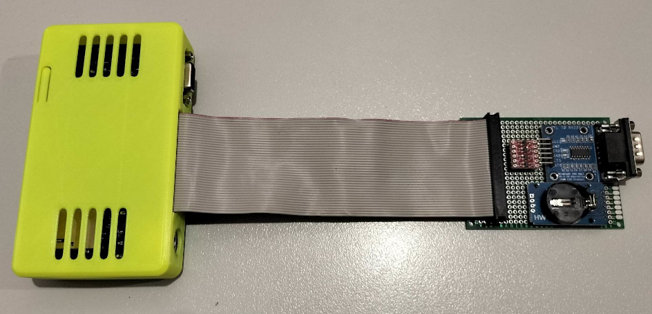

Posts: 6200
Posted: 02:48pm 27 Apr 2023
Nice picomite housing
Hawk
Joined: 15/07/2021
Posts: 159
Posted: 09:35pm 27 Apr 2023
  Volhout said  Nice picomite housing
It is really sweet, but I can't take credit for it.  It was designed by Jason Bullock.
FB BASIC Programming Language group post
It printed almost perfectly first time.  I had to file the PS/2 hole a little larger just to ensure that the plug outer housing fitted and the plug pushed all the way home.
