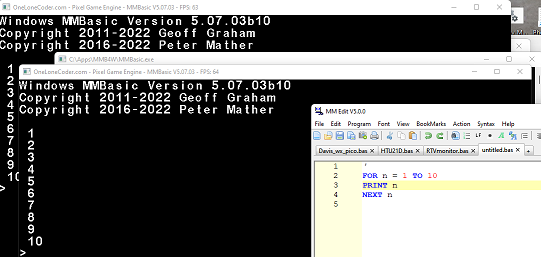

I launch from MMEdit and I get a console window + MMB4W window and the code runs.
If I don't kill those windows after editing the code, launching again from MMEdit gives me another console window but no MMB4W window. Is this just the way it is or am I missing something?
IOW, I have to kill both windows in between edits?

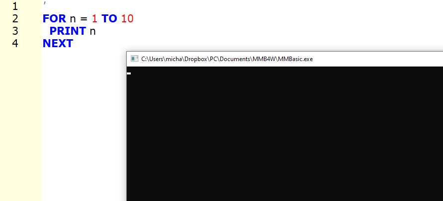

Hmm, now I only get this
Posted: 07:42am 08 Sep 2022
I can't think why that's happening.

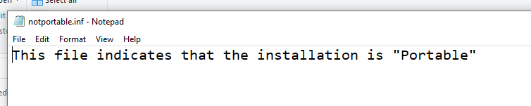

The only .inf I have is this one:

Help/About will tell you where the data files are kept.
