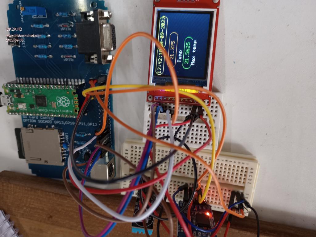

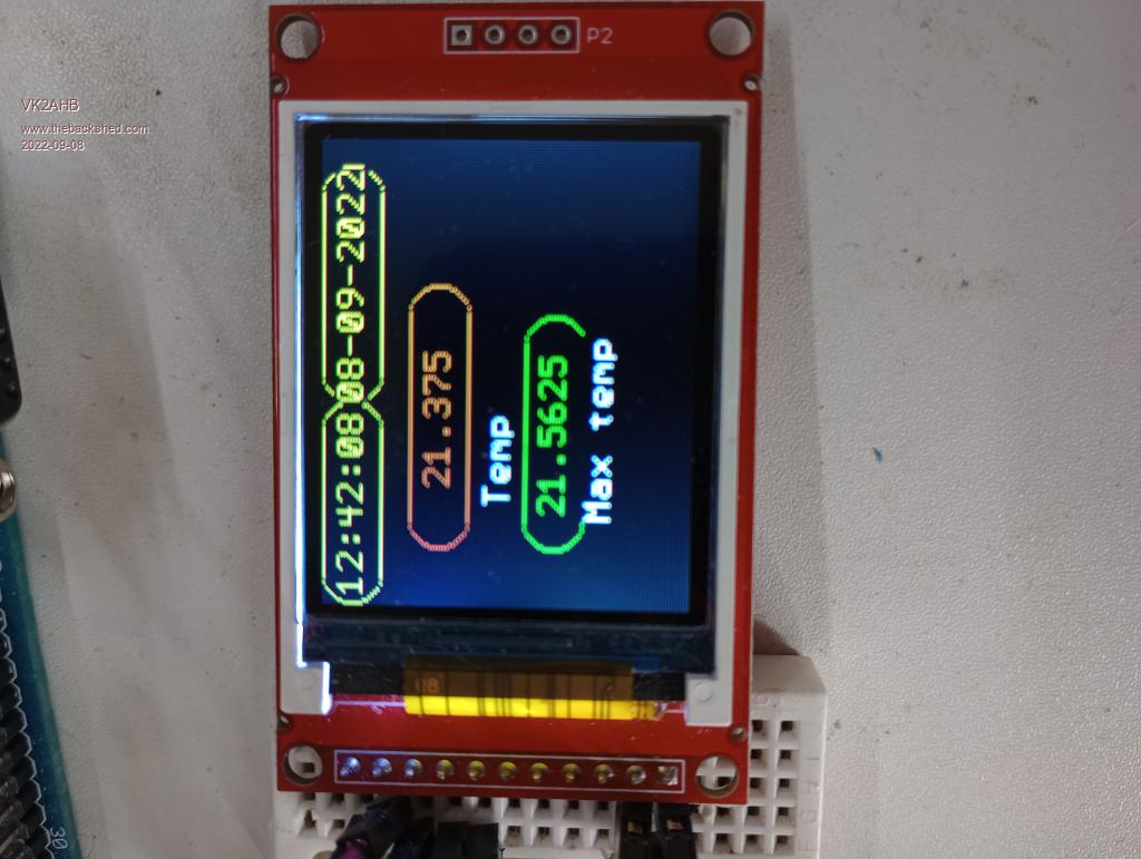

I've worked out a bit about display and number boxes and how to put values in them.
Still learning.  This is with the DS18B20 and RTC connected. Also have a DHT11 but it's not playing this time.
Occasionally, seemingly randomly, the screen goes white and I have to rest the 'mite. Maybe I bumped the wires.

The screen going white (or rather grey) is the sign of a reset of the LCD or the processor.
You are using the PCB for the VGA version of the PicoMite firmware which does not support LCD displays. I'm not sure what pin conflicts you would have using the PicoMite version (which does support LCD panels) on the VGA board but that may be the cause.
What version of the firmware are you using?  The PicoMite or PicoMiteVGA version?

I'm using the PicoMite firmware. It works well, then randomly resets.  Hitting the reset button on the board doesn't always bring the black screen back. It takes a few goes sometime.

Interesting, Paul. That PCB wasn't designed to be able to use LCD displays. :)
How have you got it connected? Which signals on which GP pins?
GP18, GP19, GP20 and GP21 should be avoided as they have resistors and diodes to GND, loading the outputs.
Also, I'd highly recommend that you use female/female Dupont leads to connect the display and do without that little breadboard. They can give wonky connections, especially with the weight of a display levering on the el-cheapo Chinese tinplate sockets.

I'm using pins 21, 22, 24 for the display and 25 the DHT11.
I'm pretty sure the DHT11 was working in VGA mode, not sure what pin I used then.

It is true breadboard birds nest wiring is prone to faults.
Wire it with female connectors as suggested previous post is more reliable.
