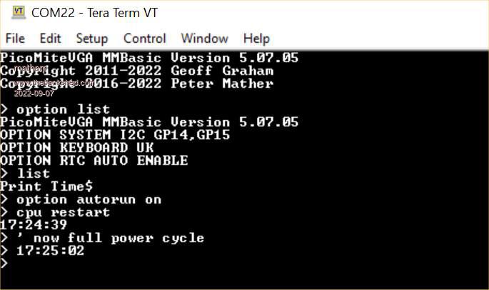

Works for me
You don't say what the "incorrect" time says

It is a bug in your code. You are calling GETDST before RTC GETIME. Swap lines 206 and 207 in the code you PM'd. Works after ctrl-C because the time/date is already set.
