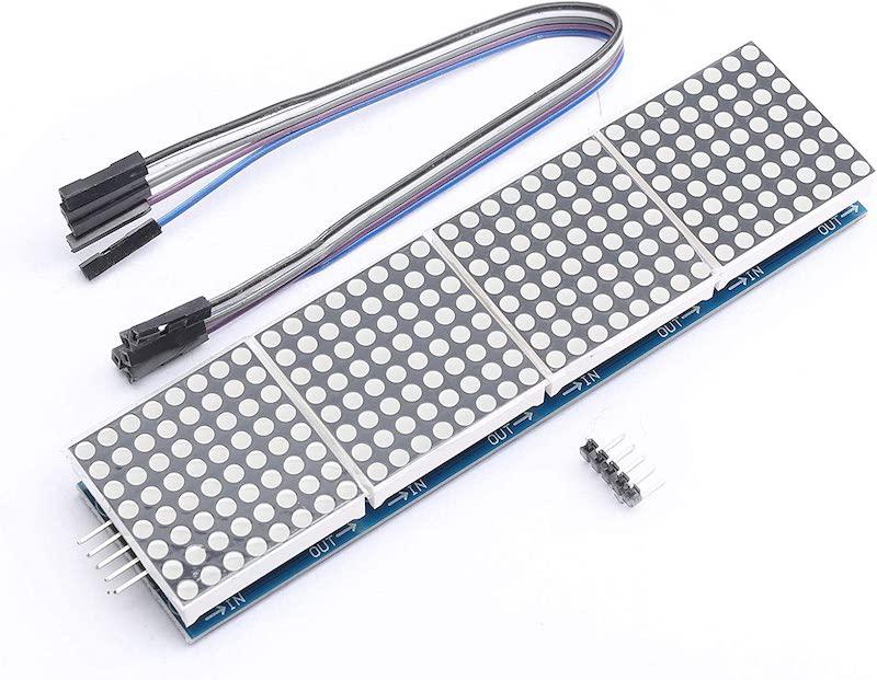

Has anyone gotten one of these MAX7219 Dot Matrix 4 in One Display Modules working on the Picomite? I got it working in Python with this hardware hookup
Raspberry pi pico       MAX 7219 PIN
PIN NUMBER
7 CS
8 GND
9 CLK
10 DIN
36 VCC
The end goal is I'd like to mount one of these on my PMVGA and send text strings   to display information and eventually be able to connect 3-4 in series and display graphics :)

No promises, but this worked 12 months or so ago with 4 separate modules chained together:
' LED scrolling text demo.
'Library Load "matrix.lib"
'Library Load "text.lib"
Save "text.bas"
' Picomite
Const m7219_clk = 4 ' GP2
Const m7219_cs  = 7 ' GP5
Const m7219_tx  = 5 ' GP3
Const m7219_rx  = 6 ' GP4
SetPin m7219_cs, Dout
SetPin m7219_rx, m7219_tx, m7219_clk, SPI
Pin(m7219_cs) = 1 ' Active low, so initially set high
'Cls
m7219_init(8,32)
'm7219_init(8,8)
'matrix_fill()
m7219_draw()
text_init()
SetTick 50, m7219_draw
s$ = MM.CmdLine$
If Len(s$) = 0 Then Line Input "Message: ", s$
text_scroll(s$)
End

You also need this font: tt4x6.zip
Note that IIRC those modules are a nuisance as they have no explicit reset so occasionally they get their knickers in a twist and have to be power-cycled.
Additionally the above contains some unnecessary stuff (prefixed matrix_) as it was part of a library that was also capable of bitbanging a homebrew LED matrix without the MAX7219 controller.
Let me know how it goes,
