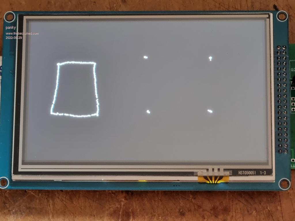

Picomite running MMBasic 5.07.05b17 with SSD1963_5 display.
All versions prior to b17 touch worked and I could calibrate correctly. GUI TEST TOUCH gave accurate display.
5.07.05b15 GUI TEST - draw a shape then 4 dots

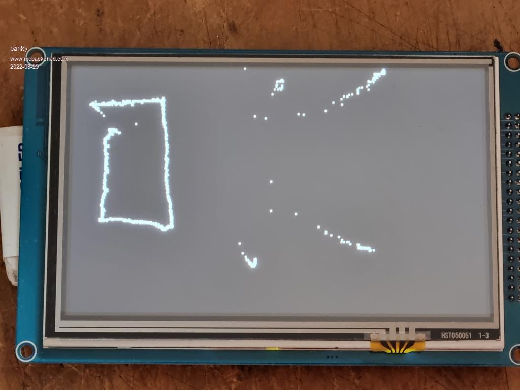

With b17, same hardware, same display, I am unable to calibrate because of wild errors (eg. x=-243 y=29, x-37 y=-77 and so forth). Manually enter calibrate values is accepted.
Have tested with 2 different Picomites, 2 different SSD1963_5 displays - everything works fine with 5.07.05b15 and prior versions. Stylus used was as supplied with display (fault still the same regardless of stylus type used).
SSD1963_5 also tested on MMBasic on a Micromite + which also works correctly.
With 5.07.05b17, when running GUI TEST TOUCH, if I touch any spot on the display I get a cluster of dots (dozens) around the touch point that seem to smear off to one side.
5.07.05b17 GUI TEST - draw a shape then 4 dots
Any advice appreciated.

I've just confirmed that GUI TEST TOUCH also gives strange artefacts (ie a single touch gives a short line and several dots, just like Doug's second picture).
