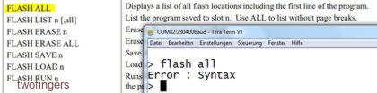

There is something that confuses me (Flash ALL).
I think it should be FLASH LIST
Best regards

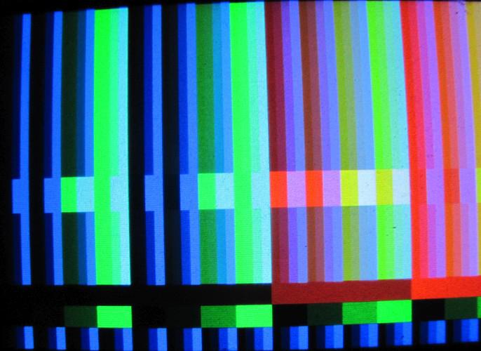

BLIT x1, y1, x2, y2, w, h
On an LCD appears to only copy 3 bit colour - RGB(1,1,1).
I imagine that is to save memory.
If it is meant to be that way is it worth noting in the manual?
This test produces a 6 bit colour bar pattern with the component colours along the bottom.
A stripe along the top of the screen is then BLITed to the middle for comparison.
'Colour bars. RGB(2,2,2) 6 bit with R G & B components at the bottom
Dim integer R,G,B,x,y=1
Dim integer xx=MM.HRes/64,yi=MM.VRes-1
For R=0 To 255 Step 85
 For G=0 To 255 Step 85
   For B=0 To 255 Step 85
     Box x,y,xx,yi,,RGB(R,G,B),RGB(R,G,B)
     Box x,yi-60,xx,yi,,RGB(R,0,0),RGB(R,0,0)
     Box x,yi-40,xx,yi,,RGB(0,G,0),RGB(0,G,0)
     Box x,yi-20,xx,yi,,RGB(0,0,B),RGB(0,0,B)
     x=x+xx
   Next
 Next
Next
blit 1, 1, 1,yi/2, MM.HRES, yi/10
Posted: 07:18am 31 Aug 2022
  Quote  On an LCD appears to only copy 3 bit colour - RGB(1,1,1).
Not sure what you mean - seems to work for me (ILI9341) - pic?
Posts: 3418
Posted: 08:15am 31 Aug 2022
On an ILI9488
Posted: 08:19am 31 Aug 2022
Do you have MISO connected through a 680 ohm resistor and touch configured?
Posts: 3418
Posted: 08:21am 31 Aug 2022
Yes
Posted: 08:45am 31 Aug 2022
Try this
PicoMite.zip
Slowed down the read
Posts: 3418
Posted: 09:30am 31 Aug 2022
You are a genius! Perfect!
