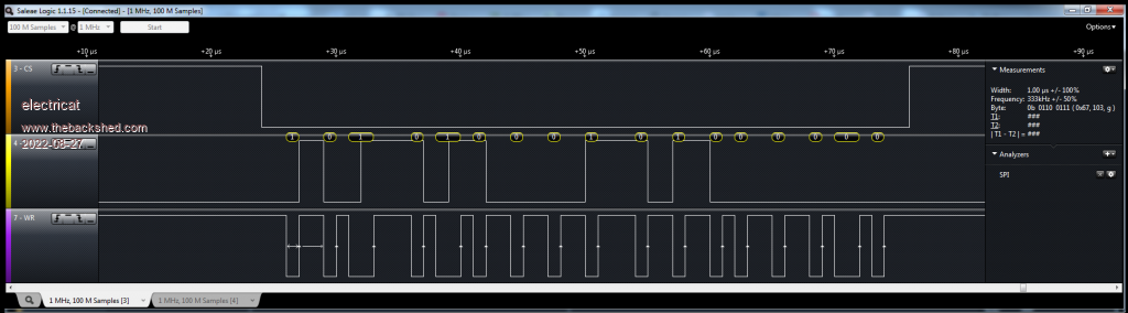

Using logic analyser I reverse engineered custom LCD driven by HT1621.
It would be easy task for any PIC microcontroller I am comfortable enough to decode such stream, but what about PicomiteVGA ?
Was thinking attach in the middle to signals sent by microcontroller to HT1621.
Read data, decode and send to  VGA screen using PicomiteVGA :)
DATA is clocked out on rising edge of WR signal at every 1-2 uS . It is pack of 17 bits sent in 50 uS x 10 bursts totaling in about 1mS for all pack of LCD information.
I failed read data using interrupts at 1uS rate with PicomiteVGA.
It might easily be my incompetence in MMBASIC for PicomiteVGA of course. But is it technically possible deal with interrupts without jitters at 1uS rate at all ?

This is custom 7seg LCD I reverse engineered.
Wanted output data to something bigger and more eye and 3d printed case friendly :) 128x64 GLCD or 3d printed and LED backlighted LCD`s replica... or just old good 2x16 LCD...
VGA screen seems be bit overkill but... how funny transition from damn small LCD it would be :)

Master who sends signals is n76e003at20. It`s 8051-based Microcontroller.
And receiver, LCD driver HT1621B is low speed serial thing accepting 4-300khz.
They did not used n76e003at20 hardware SPI pins either, but clearly serially bitbanging. And clock seems to be quite unstable 1-4 uS . Was not sure rp2040 hardware SPI would like this. But this was not a "stop" for me to try.
After CS goes low they sent 17 bits of data in one go. First 3 bits for WR command, then 6 bits LCD`s RAM adress then 4+4 bits DATA. Then CS goes HIGH/LOW and next data part comes. Ok. I decided skip 3 first bits (they are of low importance) using CS interrupt and calculate time to wait and then read 16 bits. Or read 16 bits and ignore for a while 17-th just to see if PicomiteVGA hardware SPI would take on it. (I didn`t know picomite SPI function has 32 bits. manual says 4,8,16)
So I tried :)
