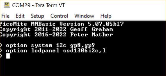

> option system i2c gp8,gp9
Error : Pin 11 is in use
it is not connected. do I wipe and start again as it may be set for spi display?
getting nowhere fast... but interesting
Posted: 08:48pm 26 Aug 2022
> option system i2c gp6, gp7  'no error
> option lcdpanel ssd1306i2c,l
Error : Invalid Option

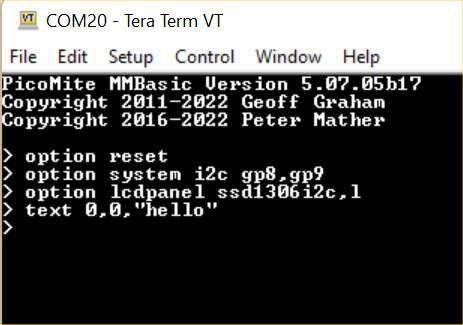

Start with OPTION RESET to clear anything there before. Then use the commands exactly as per my picture. You are using the PicoMite and not PicoMiteVGA firmware? 10K pullups will be fine but are probably already on the SSD1306 PCB
Edited 2022-08-27 07:46 by matherp

> option reset
rewired to gp6,gp7
> option reset
> option system i2c gp6, gp7 'gets this far ok
> option lcdpanel ssd1306i2c,l 'error
