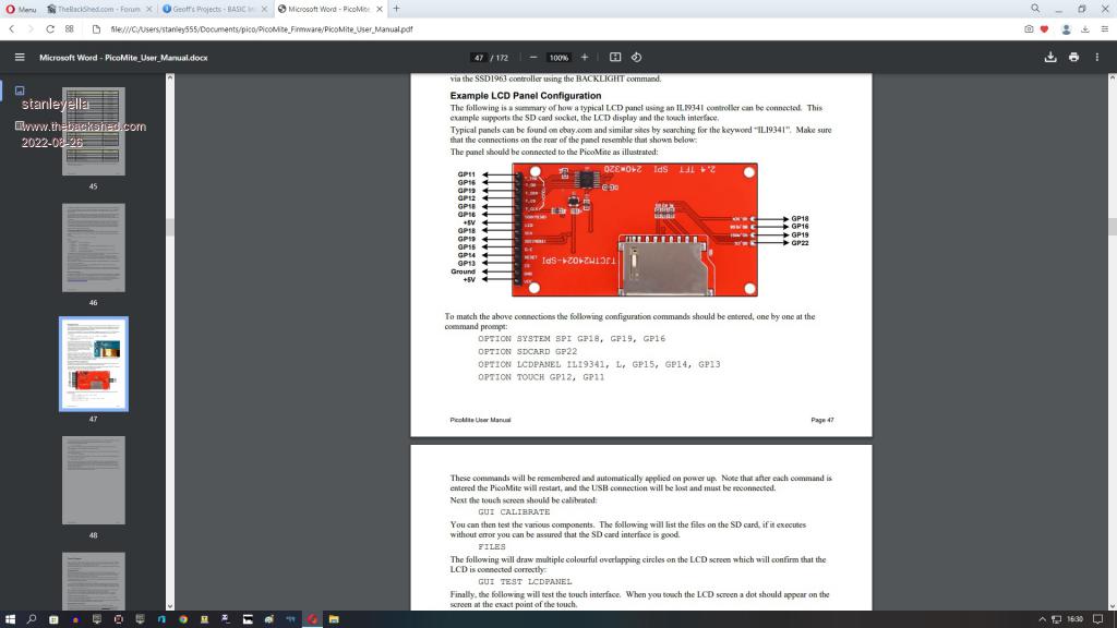

Posted: 03:26pm 25 Aug 2022
Paul, I think @panky is correct. You are using the vga mmbasic nanual.
from Geoff's mmbasic site I downloaded
Downloads
User Manual (170 pages including a BASIC programming tutorial) DOWNLOAD
PicoMite firmware V5.07.04 (includes the above manual). DOWNLOAD
Known bugs and issues DOWNLOAD
In that manual see image from
page 47
Posted: 03:56pm 25 Aug 2022
That is the "ili9341 manual". All the pixel, line, circle, box, etc. just work.
MMBasic does not use libraries for lcd devices as Arduino does... or gcbasic, which calls them include files.
I found if I wired the ili9341 as the instructions correctly (we all make mistakes :) )
then read the manual carefully, it works very well. IMHO the mmbasic graphics for this lcd are excellent. It is fast for spi. Hope you get it working.
