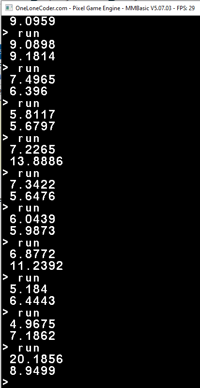

Although, curiously, when I test the same routine in QBjs, the result is consistently 2.0000000ms and the only flyer was something like 2.999999ms

I was just testing the CAT function again. The manual states that it's faster but at least the way I'm using it, this is not the case:
a$=chr$(170)
b$=a$
c$=a$
d$=a$
e$=a$
timer=0
for i = 1 to 1000
a$=a$+b$+c$+d$+e$
a$=chr$(170)
next
print timer
timer=0
for i = 1 to 1000
cat a$,b$
cat a$,c$
cat a$,d$
cat a$,e$
a$=chr$(170)
next
print timer

  Quote   The manual states that it's faster but at least the way I'm using it, this is not the case:
The increased speed is a function of the number of variable lookups in a single statement. In your code there are 6 in the first version and 8 in the second and 1 statement in the first and 4 in the second hence it is slower in your usage.
Compare the simple case
inc a$,b$
vs
[LET] a$=A$+b$
where it is 2 vs 3 hence quicker
Edited 2022-08-23 01:01 by matherp

Makes sense, Pete because on the more consistent Pico, the 6:8 ratio is pretty much what I get.
Of course, I had to try
cat a$,b$,c$,d$,e$
In the hope that the manual was wrong
