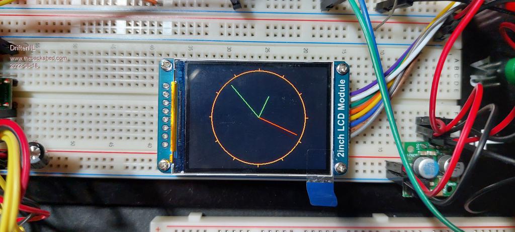

While watching a youtube video about a guy coding an analogue clock on a led matrix I got the idea to try coding an analogue clock on the picomite for an SPI LCD panel.
My setup is a PicoMite with an I2C RTC and an ST7789 320 x 240 SPI panel.
After a few hours of trial and tweaking I came up with the following:
The clock is scalable and colours customizable.
It was a fun little project and a bit of practice for me.

@DrifterNL
Another bread board user , It is fast and you can fix mistakes easier than soldered vero board, You do not need a pcb to have fun.

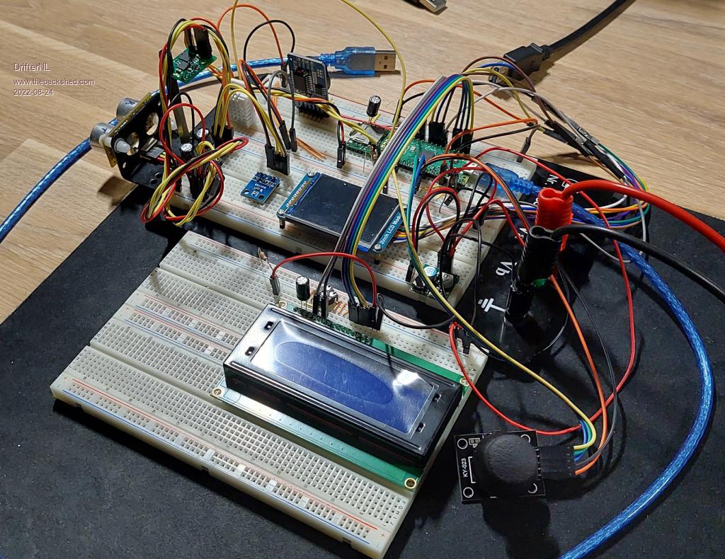

  stanleyella said  @DrifterNL
True, but if I may make a suggestion, use solid core jumpers for critical devices like an SD card reader otherwise one wrong move and files / data can be corrupted.
Here is my test set-up:

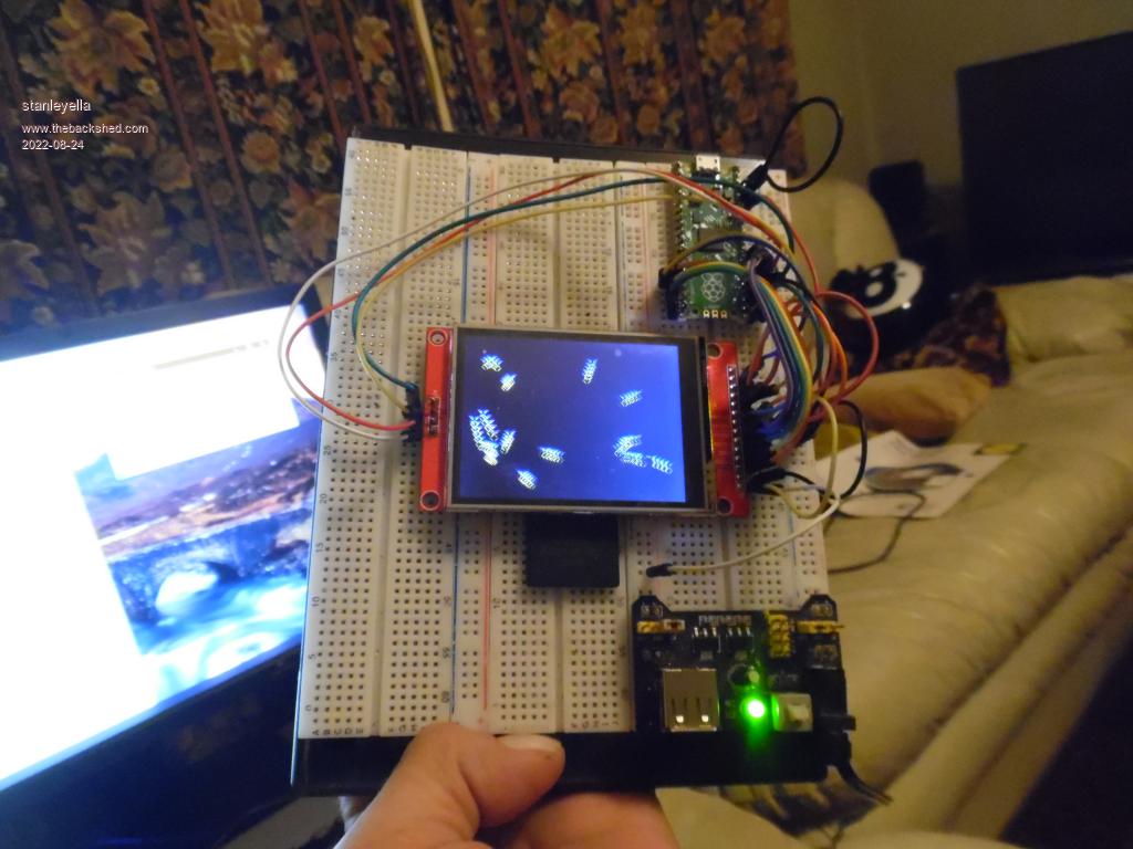

Posted: 01:24am 24 Aug 2022
I am going to make this on strip board. my picomite and lcd.
It looks like a birds nest.

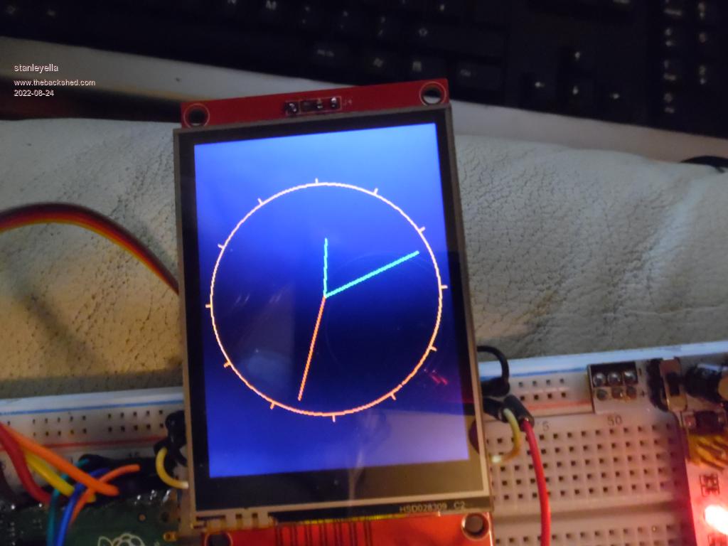

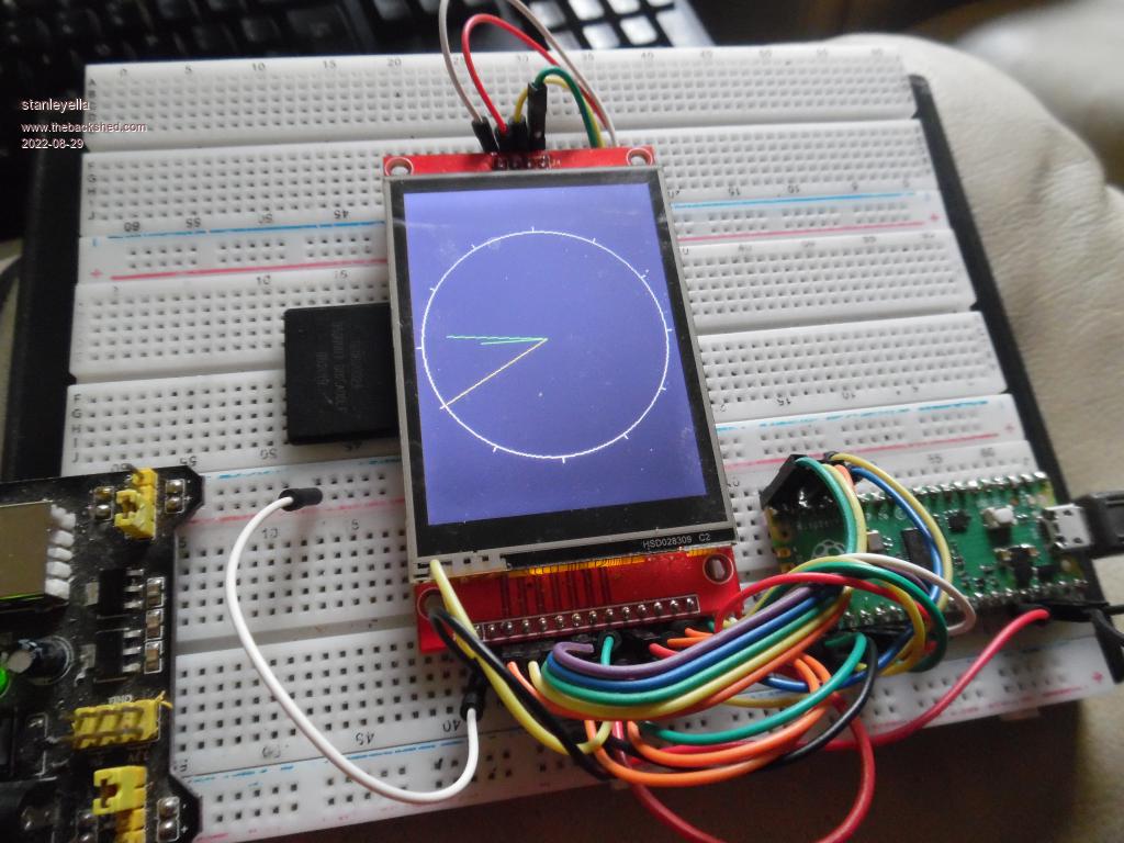

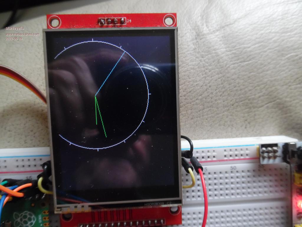

works but screen or is wrong, that is the screen setup- no problem.. Displays time in mmedit chat box??
first program I have seen that uses pi.
Edited 2022-08-29 03:59 by stanleyella

Posted: 05:56pm 28 Aug 2022
  Quote  expects 320x240 display
not 240x320 display
Posted: 06:14pm 28 Aug 2022
not 240x320 display
I got portrait and landscape boards. cheers
