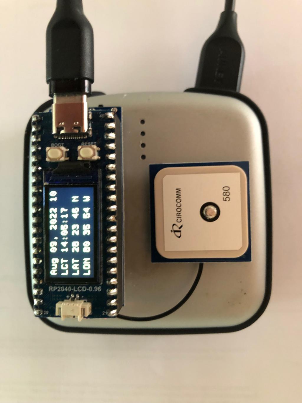

Picture of a minimalist Pico/GPS project. It uses a Waveshare RP2040-LCD-0.96 and a Waveshare Pico-GPS-L76B. The GPS plugs into the Pico/display board.
Powered by a Voltaic battery via USB. The RP2040 has a MM1.25 connector and charging circuit for a battery.
Thanks to Peter for providing the MMBASIC parameters for the display on the RP2040.

Just wondering about the pi pico "accelerated floating point" math, is it solid ?
Posted: 11:14am 15 Aug 2022
  Quote  Just wondering about the pi pico "accelerated floating point" math, is it solid ?
Exactly matches CMM2/MMB4W on cdeagles' complex solar eclipse calcs

Posted: 12:16pm 15 Aug 2022
I have several picomites that have been running my double precision sun rise/set MMBASIC code 24 hours a day for more than 6 months without crashing.
Not bad for a $4 micro-controller and an impressive BASIC.

  cdeagle said  I have several picomites that have been running my double precision sun rise/set MMBASIC code 24 hours a day for more than 6 months without crashing.
  pmather said  Exactly matches CMM2/MMB4W on cdeagles' complex solar eclipse calcs
I think that is a testament to the accuracy of your work !
However the iterative approach used would tend to give the same numerical results in any case I think.
Does the pico MMBasic version use the updated math routine library, which AFAIK superseded the standard MMBasic at the time?
Edited 2022-08-16 11:53 by zeitfest
Posted: 06:11am 16 Aug 2022
  Quote  However the iterative approach used would tend to give the same numerical results in any case I think.
Microchip S/W FP library on MM+ gets it slightly wrong
  Quote  Does the pico MMBasic version use the updated math routine library, which AFAIK superseded the standard MMBasic at the time?
Don't understand. The firmware just calls the relevant system routines all double precision.
