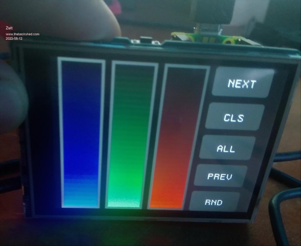

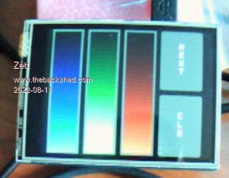

Hi ppl!,
I made some code to control a ws2812 leds(12ps)
Dim b%(11)=(0,0,0,0,0,0,0,0,0,0,0,0)
SetPin gp4,dout
Bitbang ws2812 o,gp4,12, b%()
Backlight 100
Colour &Hffffff,&H000000

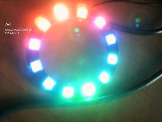

offcourse. thx dude! i now got 12 leds i can adjust the color of. from a touch schreen written in basic! this is a happy day!
now i gona make a led clock with these ws2812!

now on to the time to var program. :)
got sec$=mid$(time$,7,2) and now make it in to 5 sec steps as a var%

  Bill.b said  This is code for a Christmas display using 120 LEDs
Thx!! i can learn a lot from your code!!

Updated version.
now it got a next led button and it flashes the led that is selected.
and a CLR button. so you can set it to black again fast.
' ws2812 led circle 12

still got the idea to a save option and all leds same color

other update with buttons:
-next
-cls
-all
-prev
-rnd
Option autorun on
